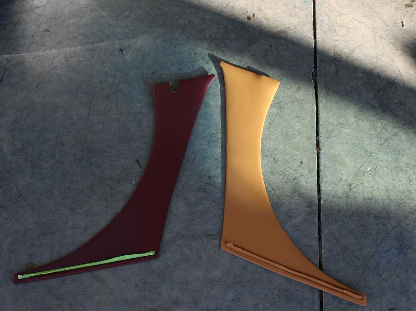

I recently won these RED side panels on EBay, however my 71's interior is Butterscotch.....so I grapped a Preval sprayer and some color matched paint and.....poof...new panels.
This project turned out better than I expected so I'm going to tackle the plastic panels so everything looks new.

Looks great. I wonder how it is for abraision resistance?

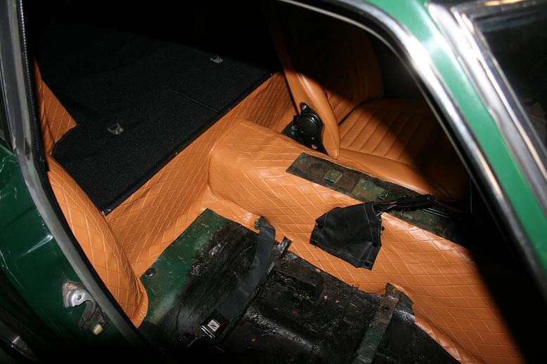

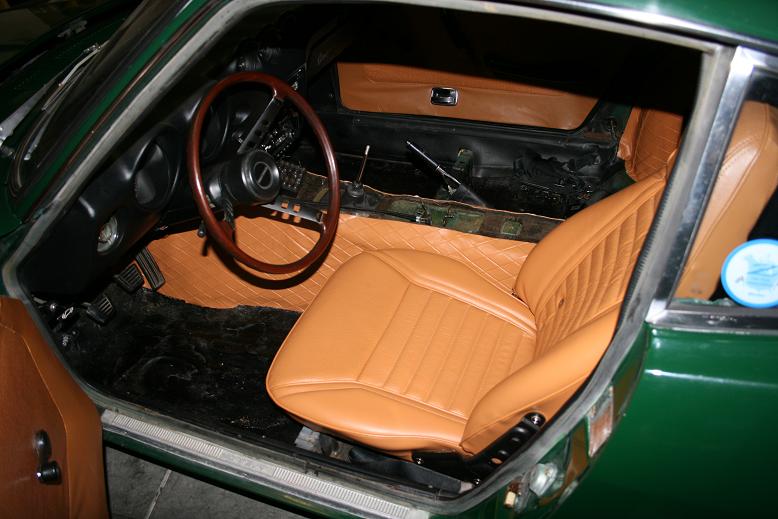

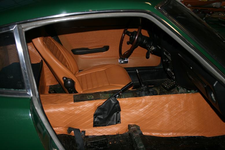

The vinyl turned out pretty good, on the passenger side trans tunnel it still has a few wrinkles that I need to work on. It was harder than I thought working with the contact cement and getting everything positioned correctly, but it sure looks better than before.
Here's a few shots of the progress. When the entire process is complete I'll start another thread with the before and after pictures.

That vinyl looks just fine to me. I see what you mean about the passenger side, but I bet it's barely noticeable with the seats in place.
