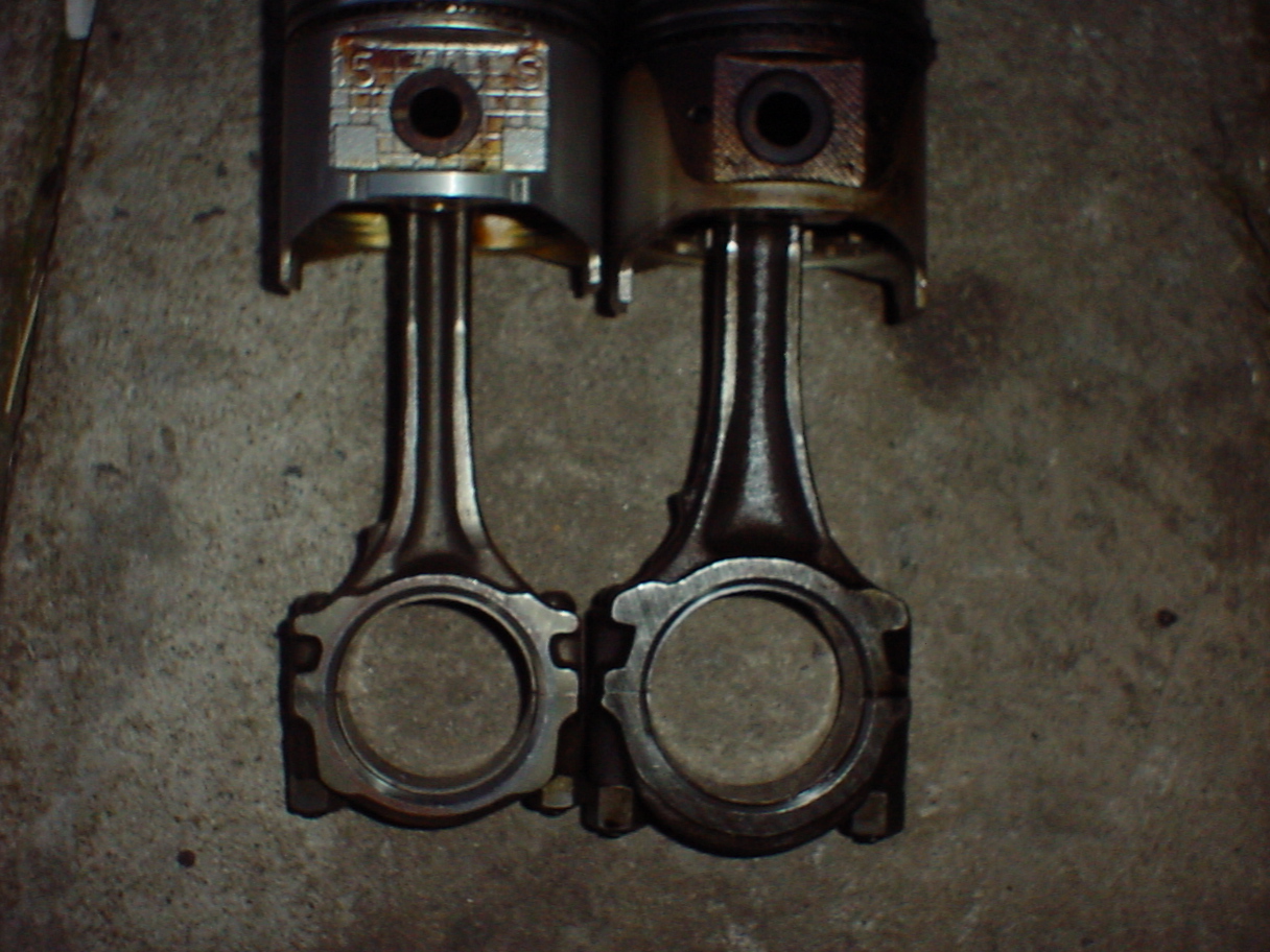

There were two different spec L20AET engines. One has heavy duty internals, like the rest of the L Series family, the other one had internals similar to the L24E (Maxima in the US, Skyline in Oz), small rods and journals.
If you look on the engine block and head, those numbers may be able to tell me which one you have.
