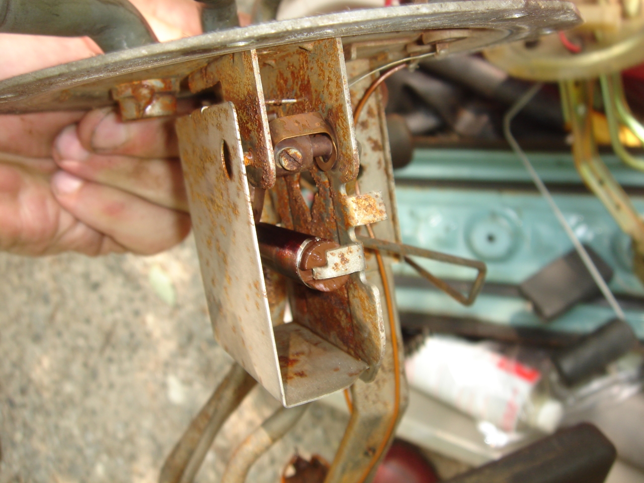

Fuel gauge reads right at half, even though I emptied the tank, then refilled.
Your sending unit may be bad or you may have a lot of resistance through your wires.

Thanks ktm, I just now did the 2nd suggestion, the speedo cable now works! As for the fuel, I think you are right. I hate to start poaching parts from my other car, but I might have to so I can get at least 1 of them complete and working correctly. I had the doors open most of today, but alas, the rain has started, so I will have to continue another day.
Jack, regarding the fuel gauge, it could also be that you have an accumulation of crud on the contact point, or the pivot points are clogged up. Attached are several photos so that you may see what I mean. When removing the sending unit, be careful. The two floats stick out at odd places, and you will have to finesse the thing out of there. Getting it back in is also a bit of a chore.
Looks like fun! Just kidding... I actually will be pulling that tomorrow or the next day. Removing the fuel rail tomorrow. Fun Fun, this WILL be a daily driver in a few weeks I hope!!
