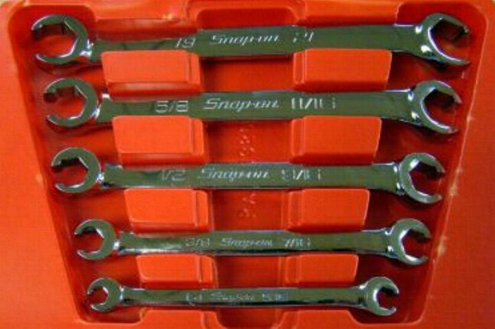

Speaking of which what are Flare Wrenches and where can I find some
cause those Vice Grips put Alligator Teeth Marks on those bolts?
You can get them anywhere that sells tools. They wrap farther around the nut which prevents it from rounding off and are designed for lines and fittings which is basically wht the EGR tube is. The larger ones I have came from SnapOn($) but you can get other ones as long a they're good ones. The ones pictured aren't mine, just a generic picture.
