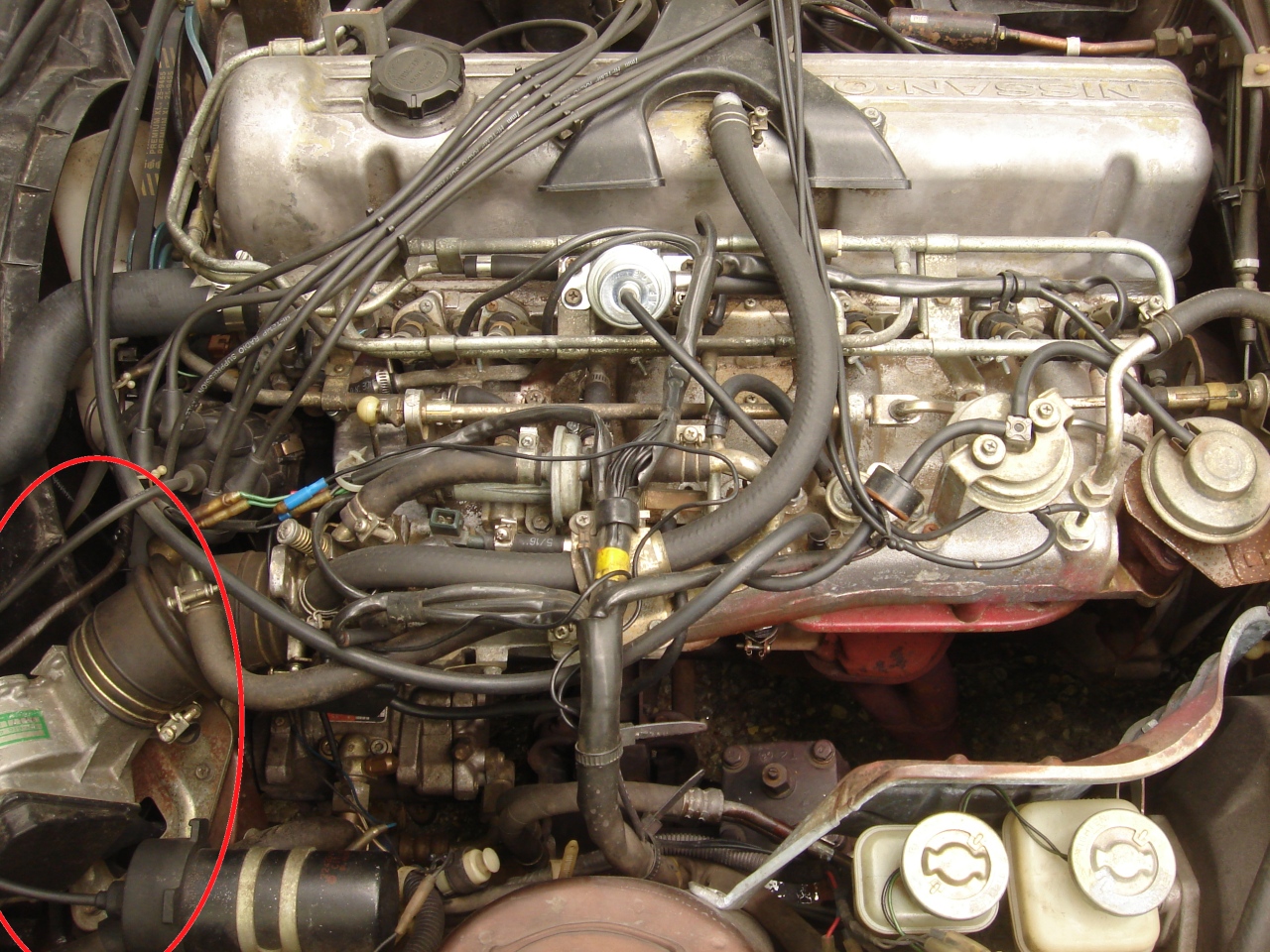

By "air regulator," what do you mean? Have you any photographs of the engine that we could look at?

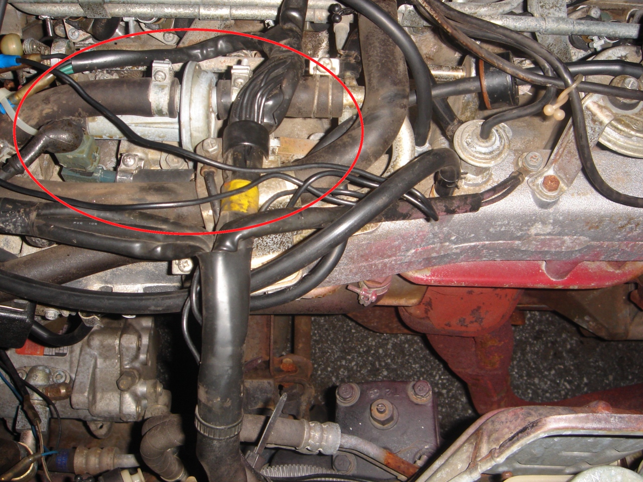

The two items in the bay that I would associate with air regulation would be those circled in these photos.
Regardless, you do need to have both of them.
Do note that I do not have a turbo engine, so your bay will be more cluttered than mine. The base location for both items will be about the same though.
David, your first picture is the air regulator and cold start valve in the circle. It wouldn't start up and run without the air flow meter circled in the second picture unless he's done some modifications that I'm unaware of.
Absolutely correct (of course) Stephen. I was just looking for some clarification on the poster's part as to help find the problem.

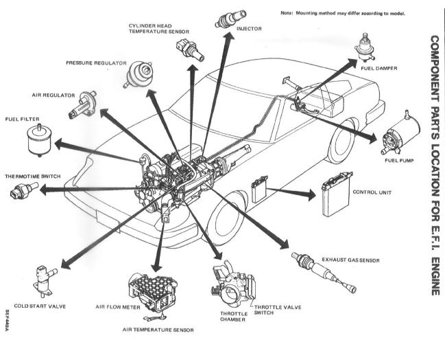

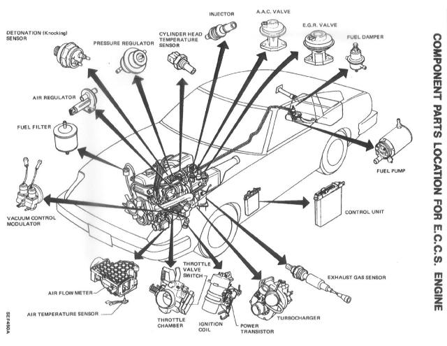

Together, the cold start valve and the air regulator act like an automatic choke on a carbureated car. You'd have to plug off a few lines to eliminate them. I'd be curious to see a picture also since a 81 turbo motor is set up differently than a 83 n/a. The 83 would have the ECCS and wouldn't have a cold start valve because that function would be in the ECU which is more 'computer' like than the 81 ECU which wouldn't contain that function. So if you have an 81 engine in an 83 there's going to be some electrical issues because the cars used different EFI systems. Your ECU will be looking for signals from components that didn't exist on an 81 engine, turbo or not.
The ZX's probably don't have Thermotime switches do they?
They did up to about mid 82 when they changed over to the ECCS system which had more functions in the ECU. These scans show the differences:
