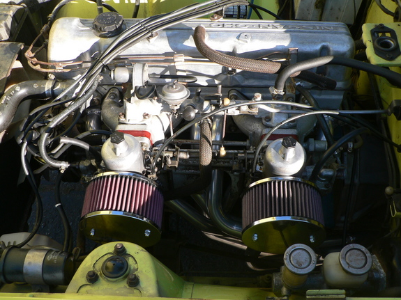

I removed the flat tops from my 73, and installed a set of 3 screw round tops. I also removed all of the smog stuff. Behind the distributor, there's an outlet tube (about 1" diameter) that comes from the crackcase, and used to go to the smog pump via a braided line. Is it okay to block the outlet off? Can the outlet tube be removed and plugged, it would look alot better without it?

It's definitely the crankcase breather (PCV) outlet. I wasn't sure if it went to the smog pump or the balancing tube. I thought it went to the smog pump, but I could be wrong. I marked just about everything when I took the engine apart, but I forgot to mark this one. I'll post a pic when I get home.
Don't really need a picture. If you plug it, the vapors from the crankcase will have to be vented somewhere or you'll have problems.
I agree, don't plug it.
The hose that you need is large on one end, and small on the other. Readily available from any parts house, Motorsport, Courtesy, whatever. It runs directly between the tube in the block that you described and the PCV valve on the balance tube.
Thanks everyone. I think the tube being different diameters at the two ends is what confused me. I'll look through my boxes of old parts, I'm sure the hose I need is in there somewhere.
