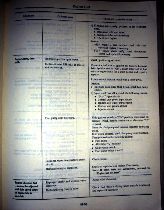

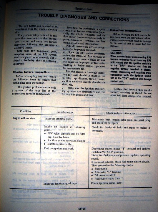

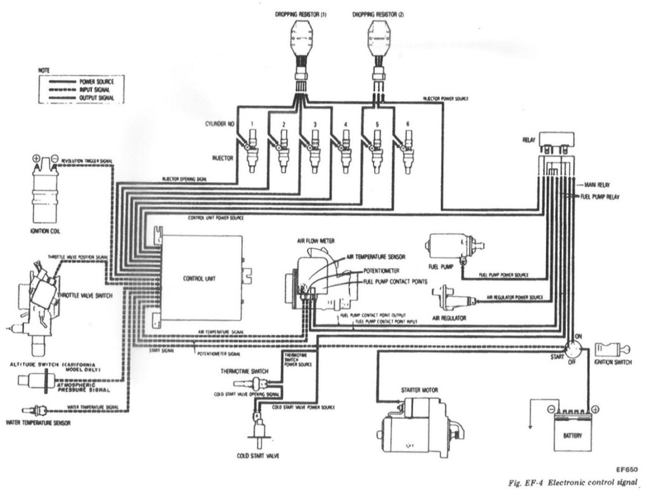

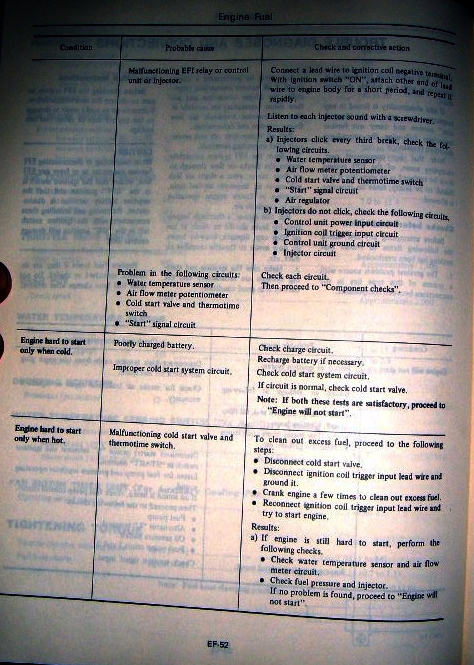

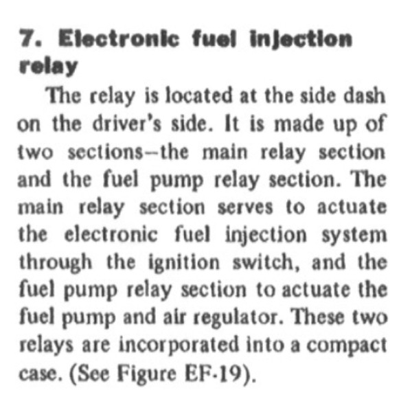

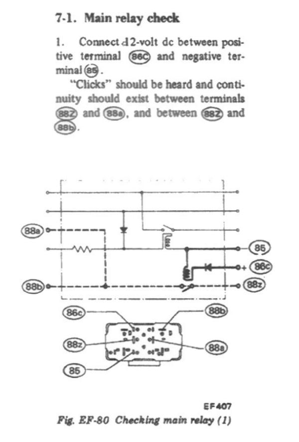

"Any thing that controls both, not sure if the ecu controls anything on the fuel pump!"
Only to turn it on and let it run for 5 seconds (at least per the 1978 FSM) if the car does not start. Otherwise is simply turns the pump on. The pressure is controlled by the fuel pressure regulator and the injectors control the metering of the fuel.
