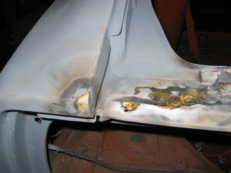

Heres the story... I got all the paint off the car finally and theres a few spots that were rusted. My neighbor, whos been helping me the whole time confidently says we should braze the rust spots to save some body shop time, fill it in with metal instead of filler,etc.
So I watch him do it, he shows me how to do it and I think all is well. I bring in some photos to work to show a guy who I know restores old 40's Willys to showroom condition. He laughs and says Im screwed cuz the brass will oxidize and bubble within a year and then eventually fall out. He goes on to explain the whole process.
The spots Ive done so far are rear deck lid the rear corners above the deck lid, one spot on a door, a few little spots under the rear doglegs, and one spot on door frame near the firewall.
I had no idea that this was a bad thing because my neighbor has seemed very knowledgeable so far. If Im screwed what do I do short of cutting out the brass to save myself here?

On the deck lid there was a large hole...we cut out a piece of sheetmetal, tacked it in then made a bead all around and ground it flush. The rear outside quarters also had a piece cut out then new sheetmetal tacked in then filled and ground down.
The 'expert' at work says brass will oxidize even under the paint through weather change or exposure to rain over time. He says theres nothing you can do to stop it. Ive searched the internet and found a few references to putting brass into metal and a few who say its not the preferred method but so far nothing says why.

Zak - Not sure about the oxidation issue - but don't give up. Ask you body shop for their opinion, and go from there. Worst case scenario is that they will have to clean it up, and "re-repair" the spots. From your photo, it shouldn't take the body shop long to set things their way.

Thanks Gary. Since I have already used brass...what shape am in? Is it possible to get away with what I've done? Im only looking for some opinions cuz the guy at work here said I'm definetly screwed, and neighbor said it was ok and suggested it in the first place.
Any special considerations for prep on this...would por-15 on the brass be a good idea?
Hey Zak, I can tell you what I know and what my experiences have been. Brazing is an effective way to fill small pin holes and join very thin metal by flowing the braze over it. The difficulty arises when proper adhesion has not been achieved, leaving gaps or small pinholes. That's the keyword here..ADHESION. This is true also for all subsequent coatings used over the repair area. Any stress cracking, pitting or crevice corrosion will allow water and air penetration to corrode the metal.
You did sandblast the area before brazing so it should have flowed on nicely. I haven't done any brazing for quite some time now but I have done more than my share. If you can, sandblast the brazed areas again before using any surface treatments. This will texture the braze and aid in the adhesion of the epoxy sealer. You want to remove any surface contaminations. There are many products available to treat the metal before sealing. I use one called Metal Prep by Alchem. After wiping this on, you have to wash it off completely with water. I have been using a non-sanding epoxy primer from PPG (DP90). This protective coating is all you will need until you turn it over to the body shop. Water can't penetrate this primer. The way to avoid problems like you are hearing about is to totally encapsulate the repair area on both sides, so nothing is exposed to air/water. If the brazing job adhered good you should have no problems. I never had any problems with braze and the coatings I used at the time were not as good as what is available today. This is how I would do it. Good Luck!
Good point Ron. I did see a few tiny tiny pinholes left in a few spots after I finished. Ill make sure I get over everything properly before I bring it in. Im on a roll here so I'm getting impatient I think.
