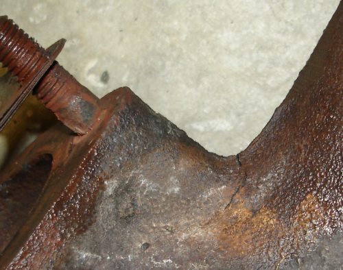

It may not be cracked all the way through since I dont see any black exhaust deposits around the crack, but it will probably only get worse. Maybe its the Z-gods way of telling you it needs a nice set of headers :)
I've been going over post after post on headers. I had some pacesetter ones years ago that wouldn't stop leaking for anything so that has tainted my view of them a bit.
From what I've read MSA has fixed the flange thickness problem on theirs and people seem to think they are decent. But since I don't plan on any other performance modifications the popular opinion seems to be it will actual hurt performance. So buying a new manifold (they show still available at one site) looks more appealing at times.
