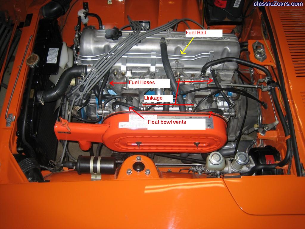

Looks to me like you're gonna need some linkage depending on what's on the SUs now, as well as a fuel rail which is missing. See pics for some clues.
Well Enigma, I already have the linkage that is attached to the firewall.... I just modified that to work in the 2 barrel. And I plan on making my own custom fuel lines. Thanks for the picture, it helped me out a lot.

Re float bowl vent lines --
Their main purpose is to keep the pressure over the gas in the float bowl exactly equal to the pressure around the carburetor inlet. Any mismatch changes fuel flow, so those tubes have to be vented to the inside of the air filter.
