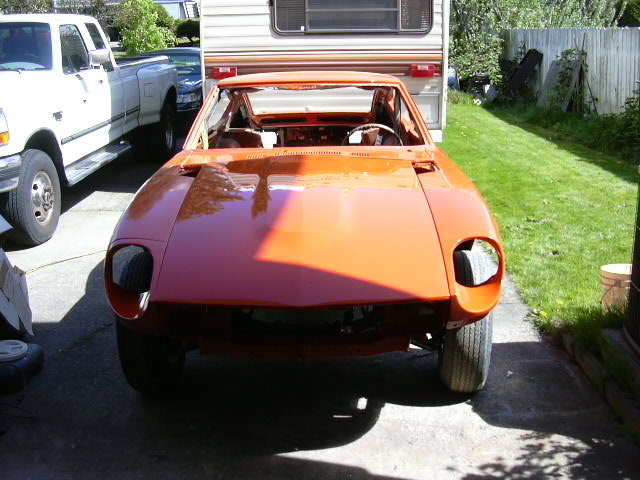

This is 27th resting in her storage tent. The stripes on the fender are paint color samples used when ZRush was built. ZRush gave me a set of fenders.
