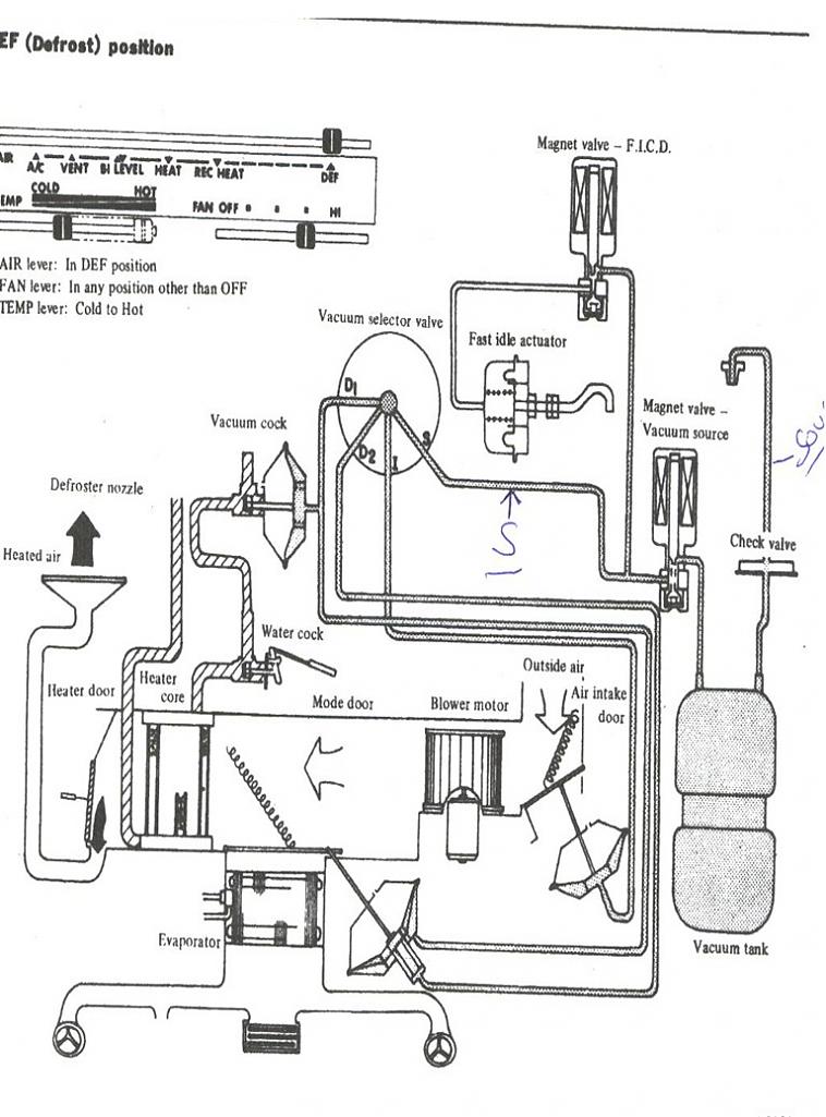

Though that isn't the best way to connect them, it shouldn't cause the problem. I'm leaning toward the possibiliby that you may have inadvertantly disconnected something while changing the connectors since the car ran okay before.
i am going to check and see if i disconnected anything, i will post pics of the area i worked on for more opinions.:nervous:
ok heres an update! so i looked at where i did the work on the connectors, nothing out of place everything connected. so I decided since i was under the bonnet to go ahead and set the idle back to stock, because at 400 rpms it wasn't even close to what the fsm recommends. so i set it to about 800 rpms and what do you know turned the ac on and reved it, and problem is gone. drove the old girl around with the ac on and she ran like a champ no stalling or dieing. thank you guys so much for all the help and the link to the fsm.
Glad you got it solved without having to mess with the vaccum lines, etc. Actually, the idle shoud be set to 800 rpm with the ac on but if it's working maybe you should leave it where you have it. I hate working on the vaccum/electrical parts of the old Z/810/Maxima AC systems and I'm a MVAC/HVAC tech.
