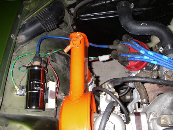

The Unilite distributor can trigger an external electronic ignition, the stock coil, or a high output coil. I think most people go straight to the extenal electronic ignition. I didn't do that, I have it triggering a chromed Mallory high output cannister coil. The distributor instructions say in my case the resistor is needed, but if triggering an external electronic ignition module, the ballast can be installed or removed (neat!). The coil instructions say this...
NOTE: Most late model cars are equipped with a ballast or loom resistor. Do not bypass this resistor when installing this coil. If there is no original equipment resistor in the circuit, use Mallory Resistor Part No. 700.
Playing around with GIMP on Linux and my camera. Here is a photo of my ignition setup. I have a bigger image going to my gallery.
