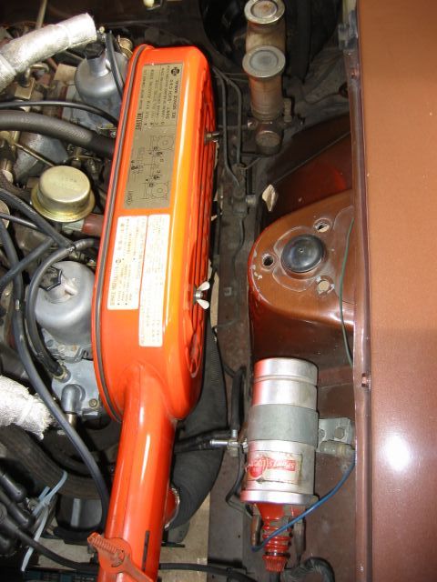

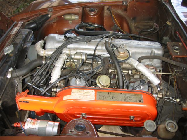

Since your 73 has already been converted to the older SUs ( a good thing) like mine, you'll want to find an air cleaner from an earlier car like the one in the pics below. I believe it came from 72 and was added when the PO converted from the crappy flat top Hitachis to the round top SUs. You should be able to find one in a JY. If not, I'm sure someone on here has a spare they will be willing to part with.
thanks. thats exactly what i needed to see. i didnt know the name exactly. they can run on K and N filters right?
