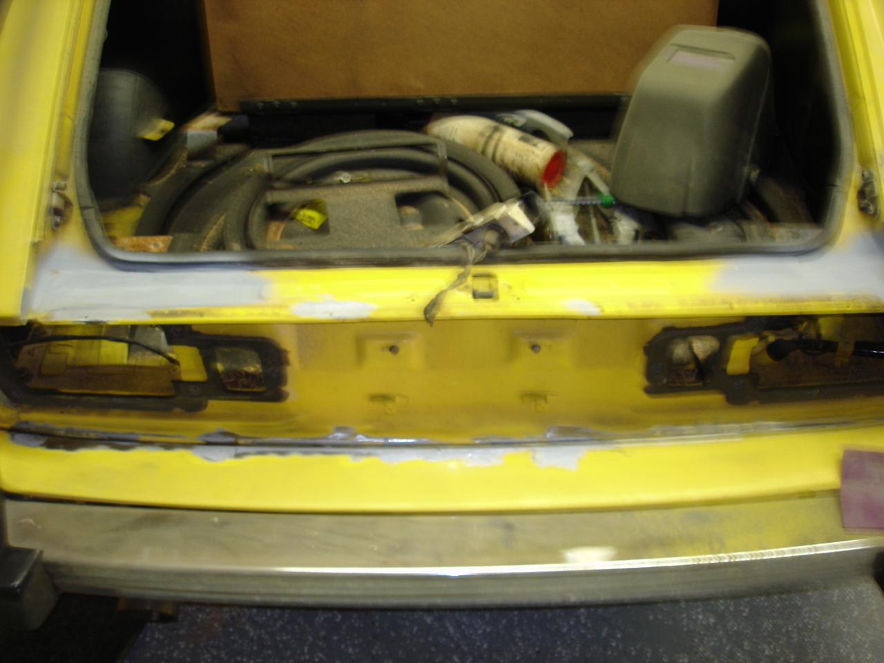

ok HVLP guys chime in here!!! Alos has anyone tried to "Seal" the gap on the rear bumper filler panel where it meets the body, the panel that is welded to the body. prob has close to an 1/4" gap, if so what material did you use! E6000,seam sealer? I am actually having a blast doing this!

I know you have a 77 280 "shaved" but could you post a picture of the panel you're referring to?
If it's the one I'm thinking of, and I may be wrong, you're referring to literally a "shelf" of metal that protrudes straight out from the body and either goes under or meets the bumper. (Again, if I recall correctly.) If so, the biggest problem you'll encounter is that what you use will be very much determined by how much vibration that part gets during normal driving.
While there are various compounds that work very well on other surfaces, when used in seams where two panels meet and vibrate out of sync with each other, you're going to have cracks develop in most filler materials. Your best bet may be to either braze or lead that seam if you truly want a seamless look.
