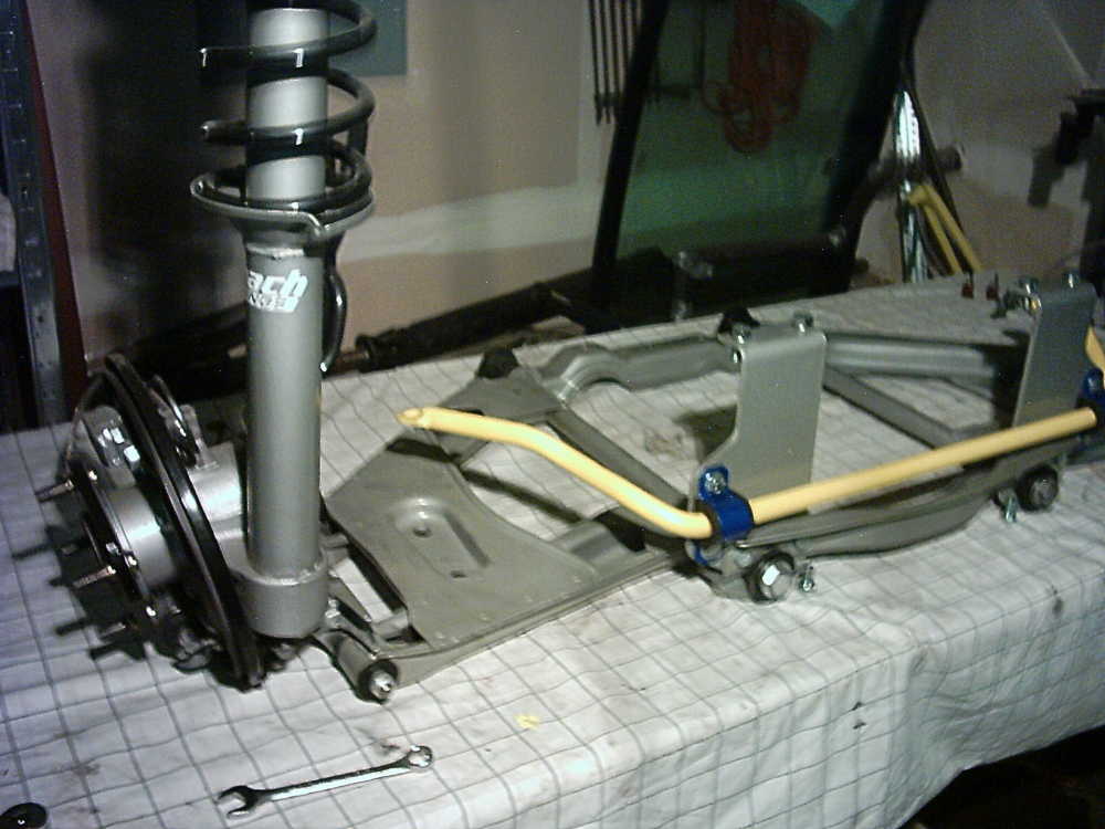

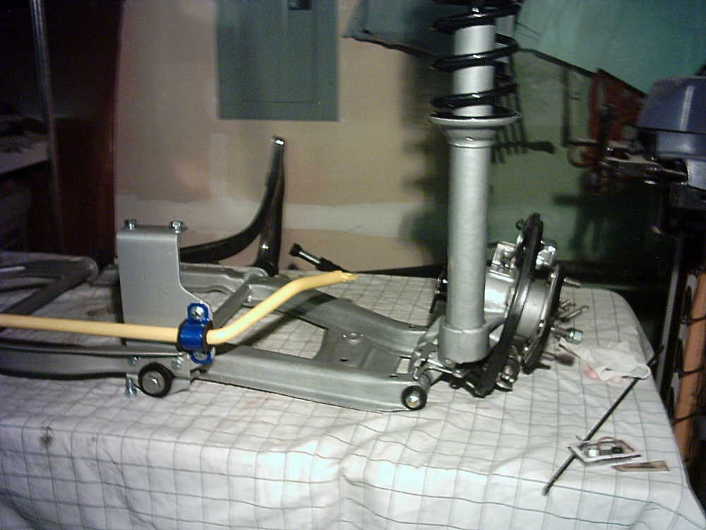

The car has been on blocks since July 2006. I was refurbishing the entire suspension assembly for the front and back: new rotors, reman calipers, shocks, spings, ball joints, tie rods, bushings, straighten a warped oil pan, painting all components, new sway bars, new-to-me transmission, new-to-me differential, etc. I have limited time each night and I am a perfectionist at heart, so I only wanted to do this once.
I took her out for a quick spin yesterday after hooking up the driveshaft and she drives like a dream. She goes under the torch next Tuesday to install some front frame rail plates to strengthen the rail around the sway bar mounts (I drilled through the rail and ran a bolt from top to bottom).

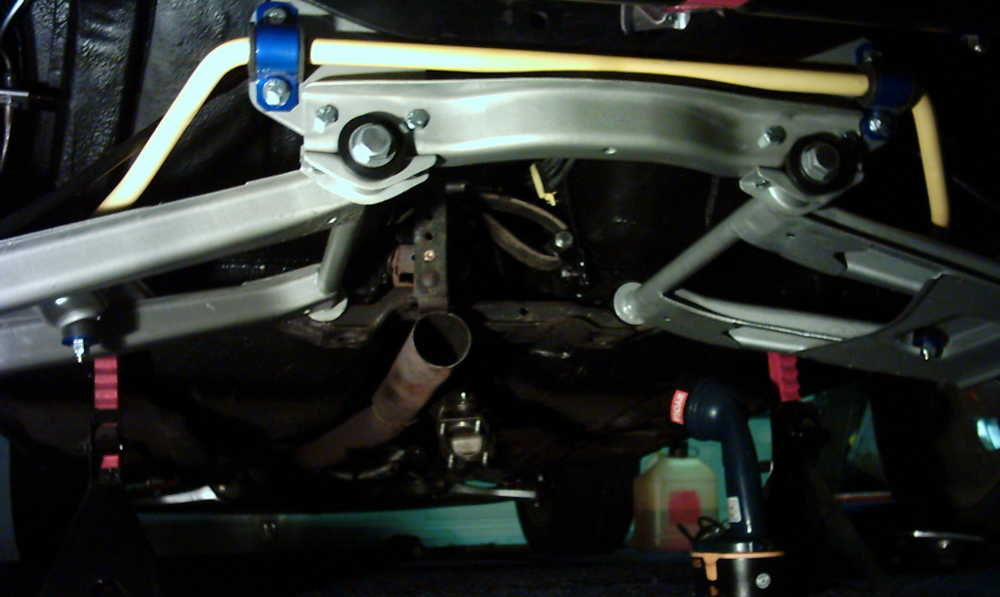

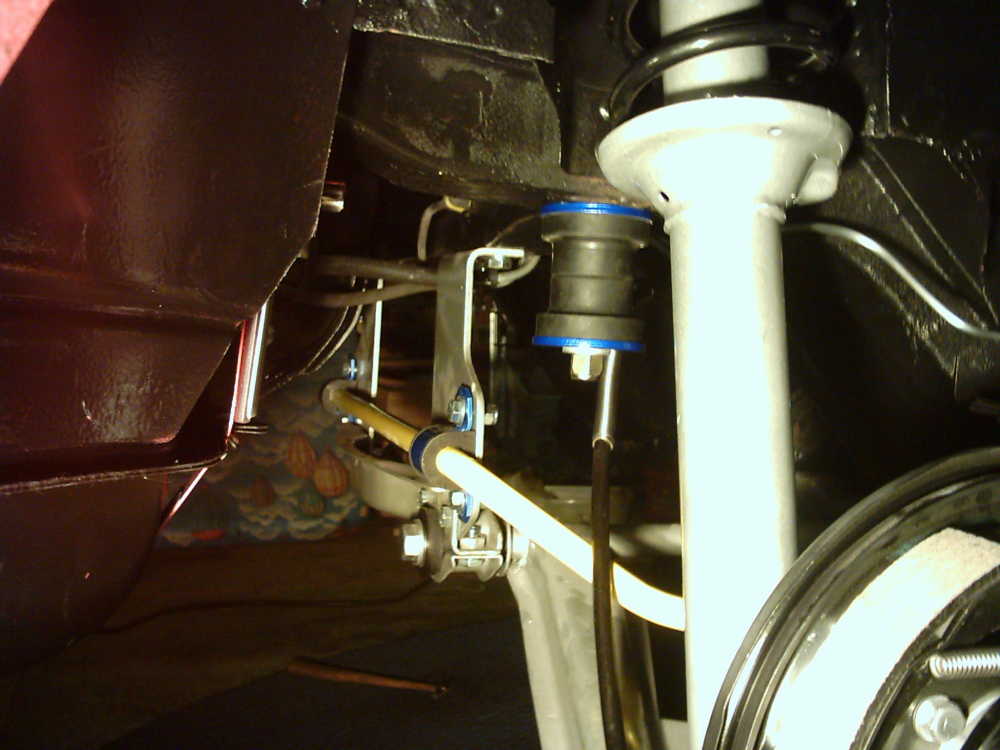

Differential Before:
Differential After:
Great job! Where did you get the rear stabilizer from?

The front and rear sway bars are from Suspension Technique. The kit comes complete with everything you will need to install the bars, to include the rear mounting bracket shown in the pictures.

I have the same set-up in my 70' (8/70') and have been told that the body mount rear sway bar is better but that's on later models. I have the 19mm on the rear and the 23mm on the front, Energy Suspension urethane end links and mounts. Made all the difference in the world when I installed it. Love 'em!!
Dave.
