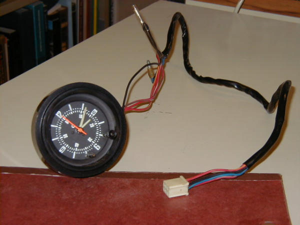

The Stop Clock (Part # 27385 E4100) is not working in my 1973 Fairlady 240Z. I wonder if the Oscillator (Part # 27395 E4100) may not be working. I have not been able to locate parts or find some help on this one. Has anyone got any ideas or working Oscillator or Stop Clock??
Regards Jack

The Clock is a stop clock, and does have a separate Oscillator box mounted on the firewall above the passengers's feet. I have not tried having it checked over by someone. I figured it would be hard to find someone who knew what it was and how it functioned.

I've been trying to find an oscilator for the past 6 years! PLEASE, PLEASE! Take your oscilator to an electronics man and have him "Back Engineer" it. I'll pay half his fee and full for a copy for me!!!

Usually, the oscillators are either living or dead. There's no in-between.
If it still 'hums' and gets slightly warm - rather like the reassuring behaviour of an old valve radio - then it is alive. If it is quiet, then it is most likely dead I'm afraid. Bringing them back from the dead is very difficult I'm told, as the internal parts that can be replaced are not the ones that cause the problems...........
Somewhere I have a Nissan-sourced circuit diagram for the oscillator internals which might aid replication, but I can't find it for the life of me. I'll have to see if I can dig it out.
