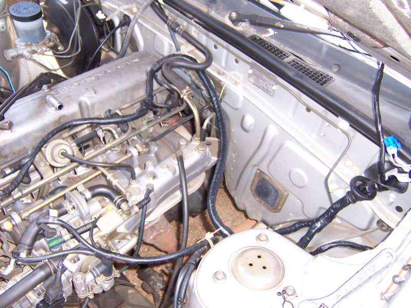

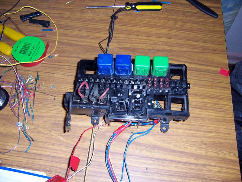

I brought a MR30 skyline, to use the EFI from,

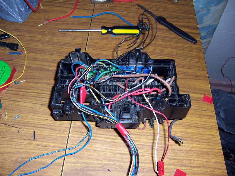

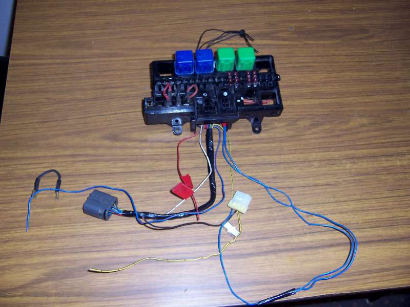

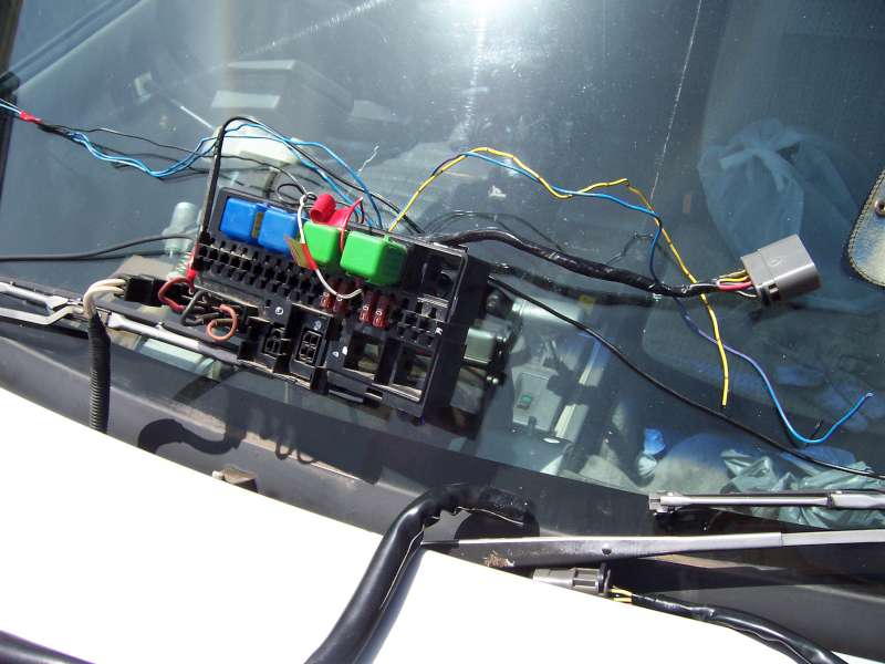

I stripped the wiring harmes out,

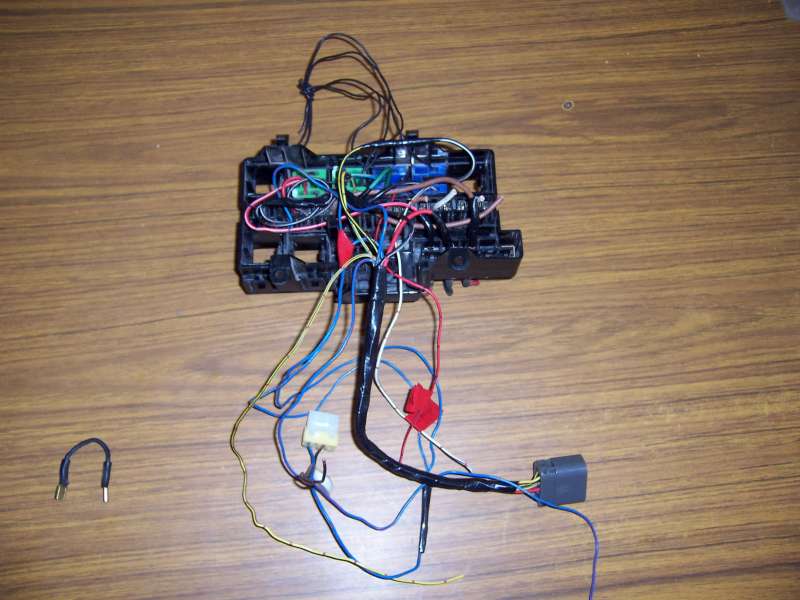

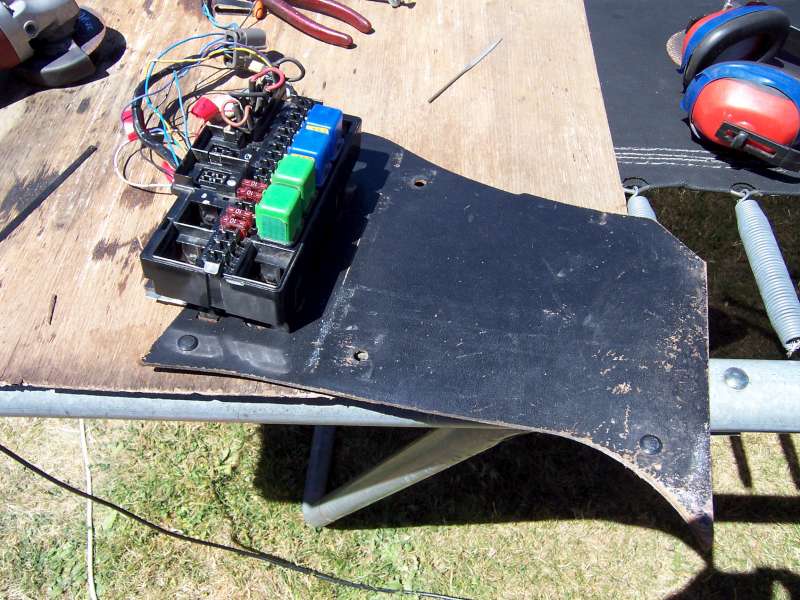

Hacked the wiring a bit, and I kept the fuse box,
plugged it back onto the motor (still in the MR30 Skyline) to make sure it was still running,
All appears to be good,

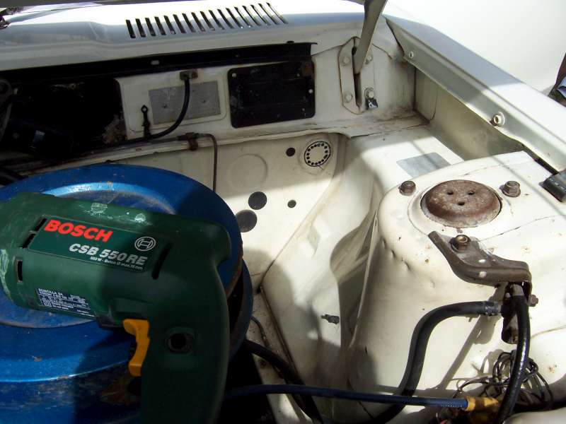

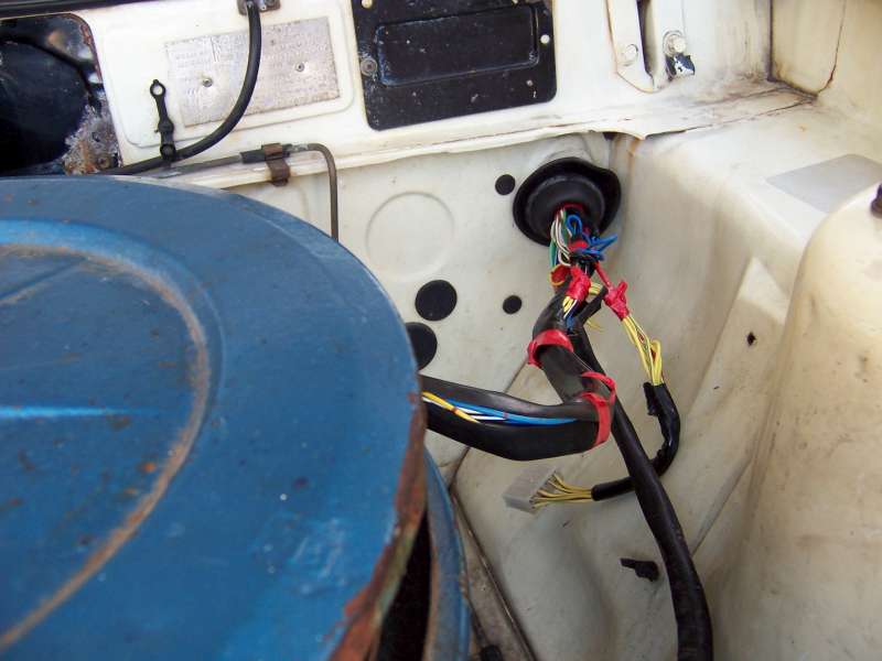

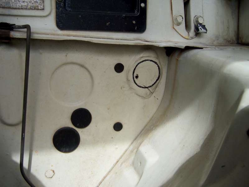

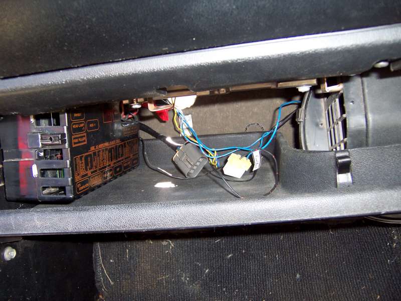

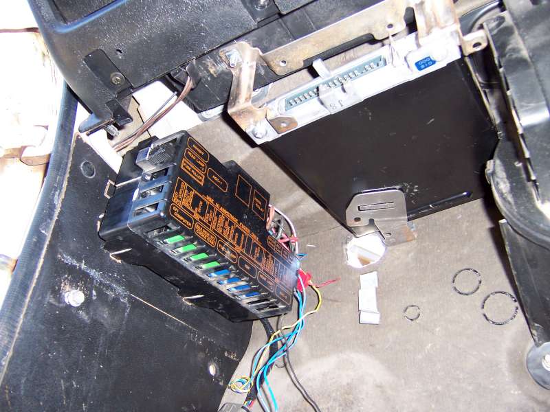

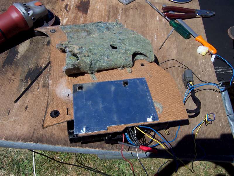

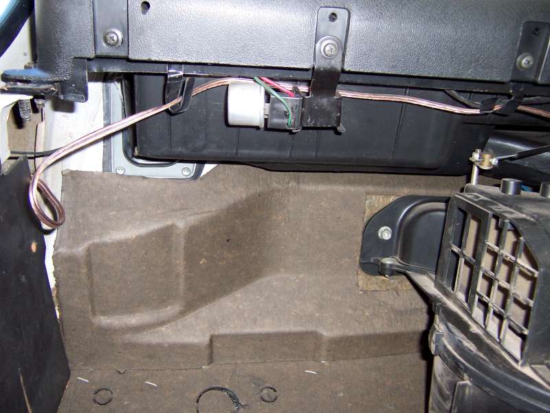

started on my 240K to see where I was going to put it (ECU), I decided under ther dash, left hand side, above the parcel tray, I put a hole in the fire wall, put the wiring through to make sure it fitted,

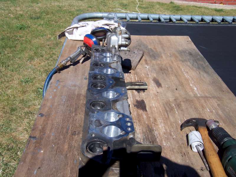

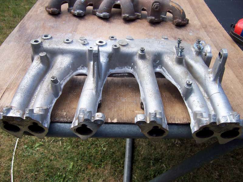

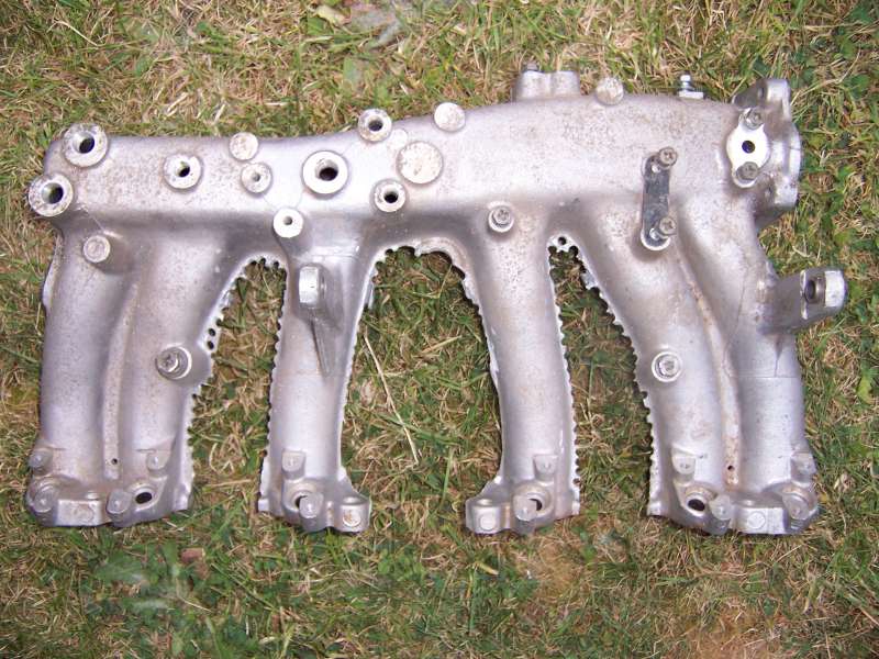

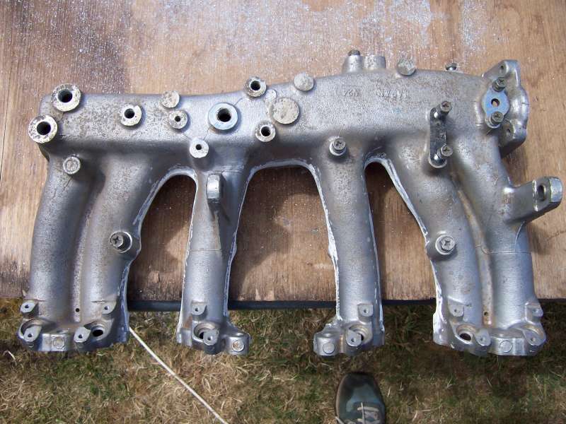

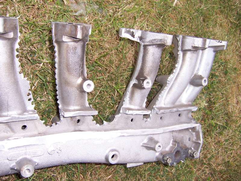

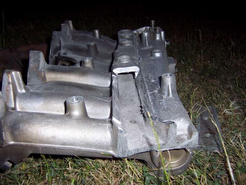

Now I'm hacking the inlet manifold, removing the webbing and EGR plenum,

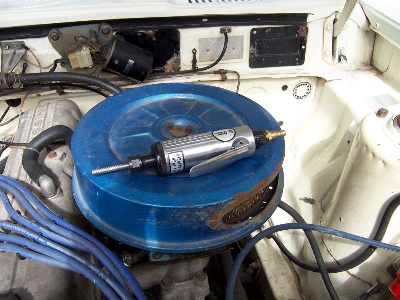

Slowing hacking away at my manifold, I found using a drill makes it easier

you're doing this for more efficient fuel delivery or you going turbo?:devious:
you're removing the intake flash because it looks better?

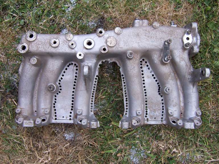

How are you going to block up the holes underneath the manifold?
Would have been easier to get a N42 Non EGR intake manifold off Ebay usa.
No egr valve, no webbing, no welding up holes.
Some one suggested threading the holes with a pipe tap, and putting in some bungs, I though about using small welsh plugs, I did do a search on ebay.com.au, and didn't come up with any hits, since I'm not in the US, the freight would be a killer, and since I'm trying to do this on the "cheap" my time is free.
Mat Big Hat, 4 reasons, more fuel efficient, a little more power I would think, It will look nicer, and it will make it easier to get to the manifold studs. At this stage, no turbo, but when I build my L28, I want to go that way.
aarc240, I've spent about 3 hours working on the manifold now, probably a day on the wiring, but since I'm doing it, it's not costing me $40 to $60 an hour..

I filled up a whole in my K manifold with epoxy steel and drove it for one year without any problems at all. I'll post a photo shortly.
It was a product called JB weld and was bought at a small auto shop in Australia. I'm certain this would fix your problem.

Some more pictures,
I may polish it a bit, but thats all the material I will be removing, carbite tools bits are to expensive to buy..

Some one suggested threading the holes with a pipe tap, and .....
....adding NOS injection LOL
I did do a search on ebay.com.au, and didn't come up with any hits, since I'm not in the US, the freight would be a killer.
Nigel
Yep you'd have to get one from USA. Freight is about $40 by surface mail. Took mine about 2 months to get here.

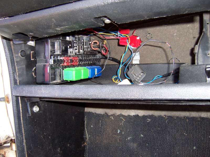

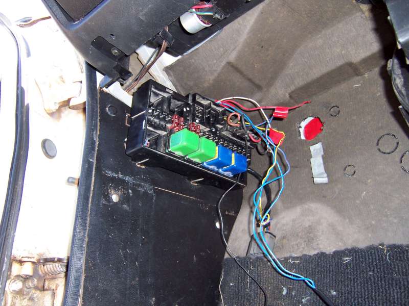

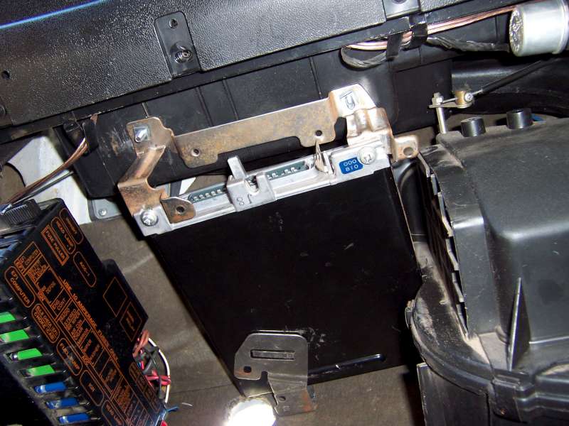

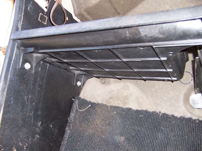

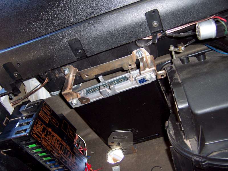

I spent a few more hours today mounting the fuse box / relays and ECU, as you can see in the pictures, I dont think it looks to bad..
