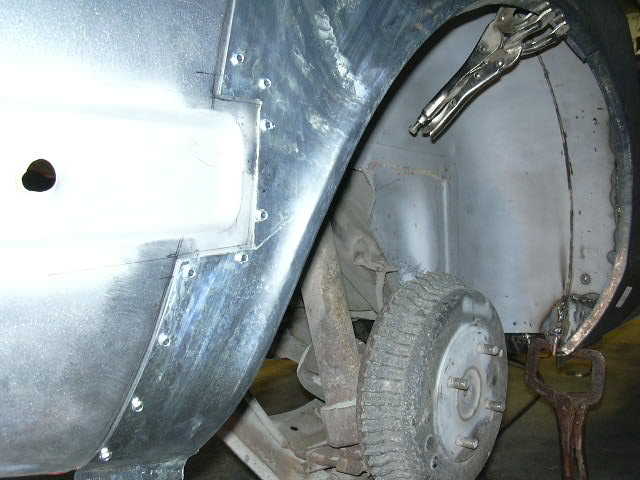

I took an old front fender and cut it into pieces and welded them back together. I used a crimped seam. Where one panel lays on top of the other. It is a lot easier to weld and hold in place while you weld it. Here are a couple of pictures showing my quarter panel repair panel screwed into place before I welded it on to the car.
The first picture shows that the cut line and the panel line are five eighths of an inch different. That is where the crimp goes.

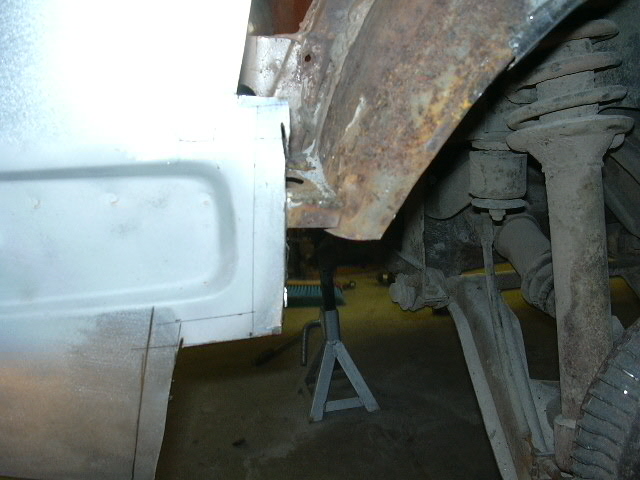

The second one shows the patch panel screwed in place. Took a couple of hours to get this right.

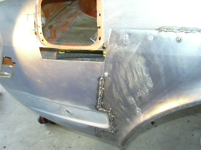

Third one shows it welded in place before I ground the welds smooth. Another time you must be patient is while you are grinding these smooth. Do your self a favor and go to welding supply store and get "easy grind wire" it is a softer wire that makes this whole process much, much easier.
