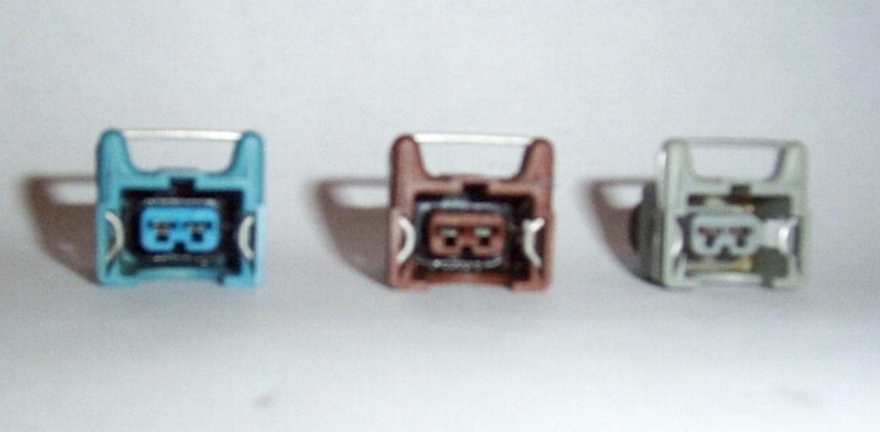

In other words, do you sell these connectors and boots which are the ones we've been discussing here. I clicked on your link but didn't see them. If you do have them what's your price?
Sbake01 I bought a brand new pair of 6, and they worked on my car, I bought them off ebay a long time ago for I think $30.00 plus shipping. I think I still have the heat shrink.

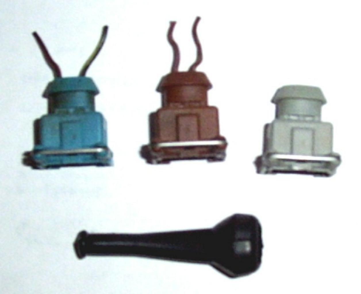

I don't need them. I have plenty. I was just wondering if the one's jmanz6 sells as the "good connectors" are the ones I pictured. The ones I pictured are far better than the OEM regardless of what anyone says. Trust me on that one! I'm the old fart with years of experience with these cars. I'm not looking for advice or endorsement from anyone on these. My cars both have been upgraded to these. Years ago on the 810 and last week on the Z because it really didn't need them up until then.

it goes the ones I sell that are far superior to the OEM ones. They don't have the boot you think is so great, they have a silicone plug that slides over the wires and presses into the plug body to keep the moisture out. They also have the quick release tabs to allow you to take them off without damaging them.

....They don't have the boot you think is so great...
