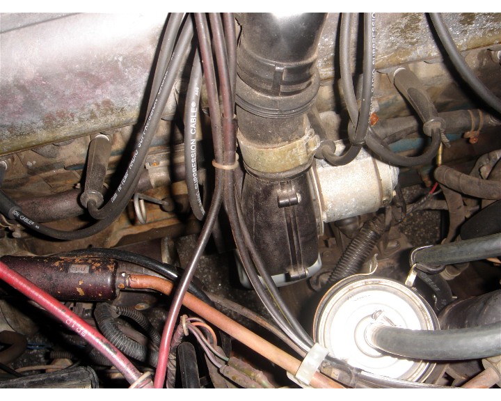

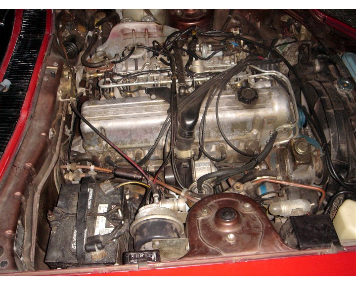

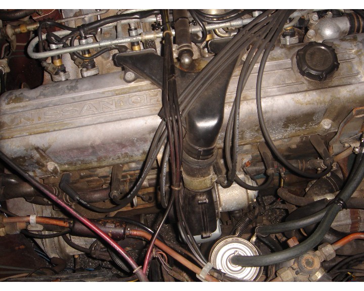

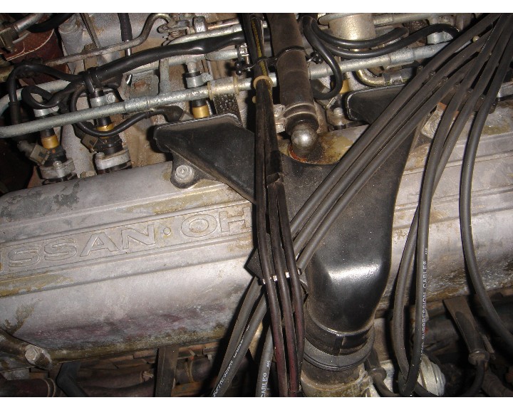

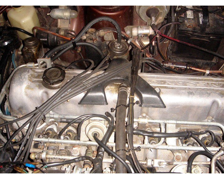

My '78 280Z does this too, does anyone have a picture of this auxillary fan setup? My car always does this in embarassing situations, like when running errands, and i would love to find a way to fix it.

Thanks for the pics zbane I always wondered what those black things the ZX's have on their valve covers were LOL, now I know.
