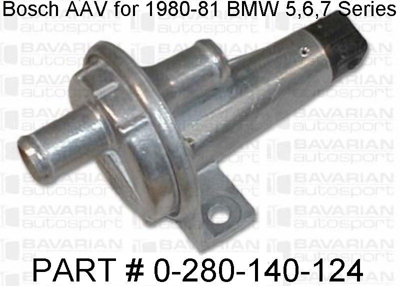

ok turns out im a moron. When i pulled the wires under the car to connect them to the new pump it ended up pulling the bullet connector under the seat apart. LOL good times! One more question... does anybody know where i can get an aux. air regulator for that? Nobody has em!
.........One more question... does anybody know where i can get an aux. air regulator for that? Nobody has em!
I have a couple that work. Is your missing or just not working? PM me if you need it. Or if you want a new one try here. I know it's for a BMW but it works. We discussed that here in a thread a couple of years ago.
