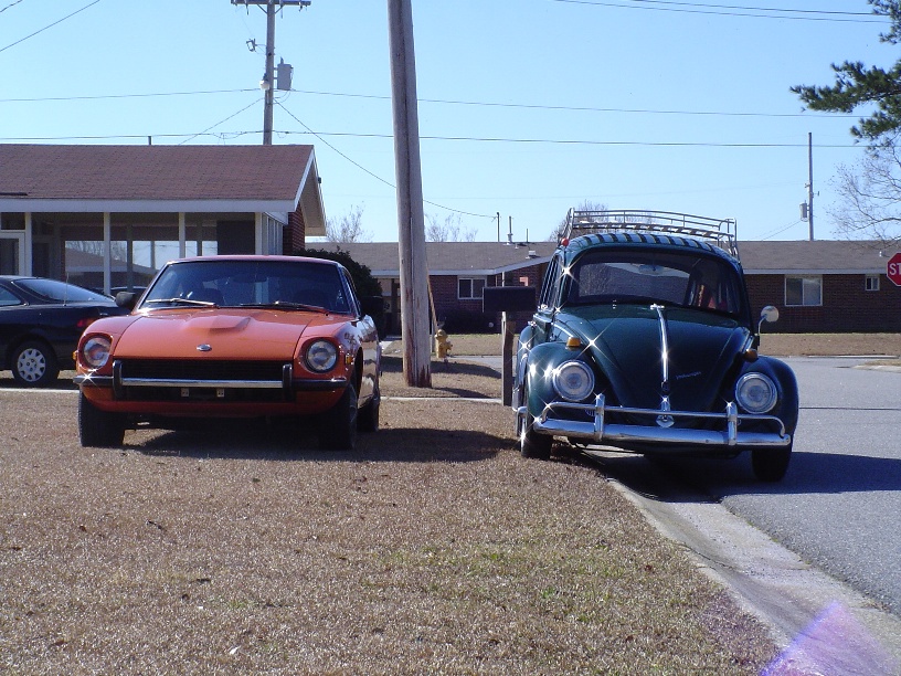

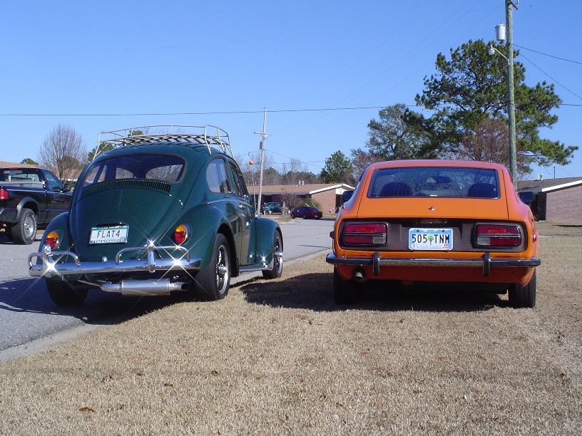

May 29, 200619 yr comment_169144 Back in South Carolina, a friend of mine had them paint his 65 Beetle. He used either the cheapest level or the next to cheapest level and it didn't look half bad either. He did all of his own body work and he put 1/4" rope behind all of the window rubber so the paint would get behind it. Also when we got there he pulled all the lights off. He also pulled the bumpers and other chrome pieces off too. Basically he wanted them to screw up as little as possible. He went with a nice British Racing Green, you really have to trust your bodywork and the guy with the gun when you go with a dark color. That was about 3 years ago and it still looks as good as the day it was done. Here's a pic... sorry I don't have any close-ups. FWIW- Nate Link to comment https://www.classiczcars.com/forums/topic/20128-how-far-will-maaco-go-for-you/#findComment-169144 Share on other sites More sharing options...

May 30, 200619 yr comment_169169 Lance-Good info... may make others think twice about where to go for paint/body work. Nova looks great! You can even make out y'alls reflestions in the black stripes.Nate Link to comment https://www.classiczcars.com/forums/topic/20128-how-far-will-maaco-go-for-you/#findComment-169169 Share on other sites More sharing options...
