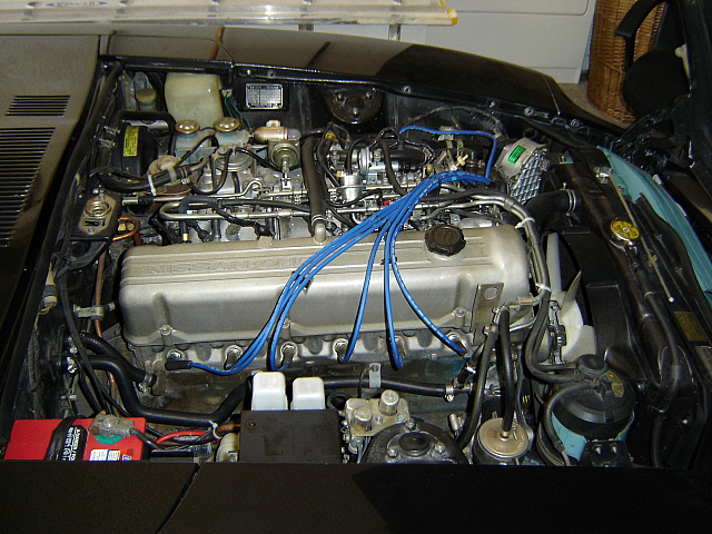

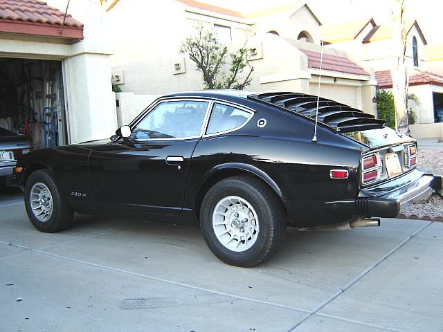

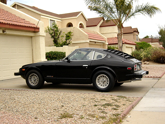

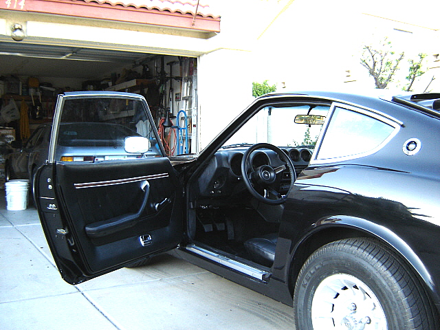

Posted May 20, 200619 yr comment_168135 Hi All, Just finished painting and re-assembling my 1978 Black Pearl 280Z. It doesn't really qualify as a Black Pearl anymore because I used 2005 Nissan Altima, (Super Black) for my paint. But the car still has the original paint sticker with the 638 number. The car was an Arizona desert car which means rust was very minimal and I'm aware of all the places it can be a problem. I went through the entire vehicle but the body/painting work took 75% of the time involved which is why I'm posting it in this section. I've been a member for a little over a year now and have read hundreds and hundreds of posts while completing this task. The entire suspension is new with the exception of the springs. I also replaced the seat covers, carpet, windshield, complete weatherstrip kit, rack & pinion, tires and many, many other items. The engine produced some pretty solid numbers on a leak down test so nothing was done to the internal engine. I did replace all of the sensors including the electrical connectors, the fuel pressure regulator, fuel pump, auxillary air valve and one injector. I kept a reasonable record of my time and I have a little over 300 hours and $5,200, (that includes the price of the car) invested in the project. I did the bodywork and painting in my garage. Like others have said, there's a reason a good quality paint job costs as much as it does. I did the Skim-coat, block-sand, guide-coat routine, over and over and over until I achieved flat/straight panels. Overall, I'm very satisfied with the results. There is a huge sense of accomplishment in painting your car and having it turn out right. When the body was finished and ready for paint, I was thinking of having it shot by a paint shop. I'm glad I forged ahead on my own and I encourage anyone contemplating the effort to give it a try. Preparation is the key. Tony D, a member here suggested using a self-contained Turbine HVLP paint system from Harbor Freight for painting so that's what I did. The unit costs $100 and it worked out, I had my doubts but I was wrong. I still have some faint traces of orange peel here and there but I'll wait until the fall to guide coat the clear and buff the paint back out. For now, it's driving time. Hopefully these pictures upload and look OK. Link to comment https://www.classiczcars.com/forums/topic/20115-newly-painted-280z/ Share on other sites More sharing options...

May 20, 200619 yr comment_168141 Looks EXCELLENT!Paint reflection doesn't show any irregularities.....smooth panels.....check.Color / Shine consistent and crispy clear......check.Judging from the pictures, I'd give it an A @ 10 ft, but that's just......my 2¢ Link to comment https://www.classiczcars.com/forums/topic/20115-newly-painted-280z/#findComment-168141 Share on other sites More sharing options...
