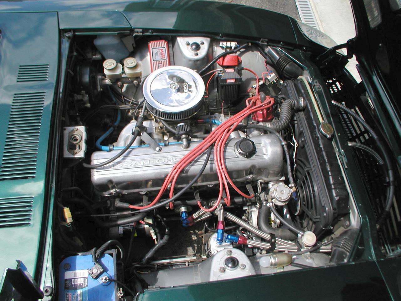

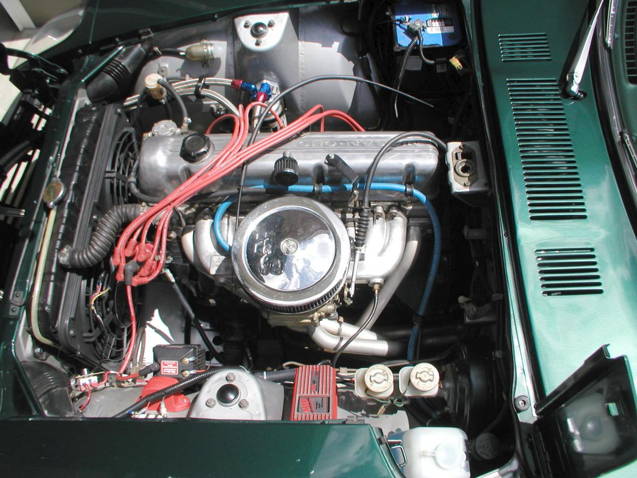

July 22, 200915 yr comment_290155 I don't know ChrisA if this helps but here's an MSD 6A hookup I used with the Mallory Unilite Breakerless (LED) Distributor and Mallory Promaster Coil. Thanks to Dave Irwin (ZsOnthebrain) it works flawlessly and my engine runs super especially since my plugs are gapped at .060" . The nice thing is that my stock 240z Tach works as well. I've attached the documentation for my hookup as well as a few high level engine photos. Many thanks ... MSD 6A Wiring 05-13-08 Layout.doc Edited July 22, 200915 yr by moritz55 Link to comment https://www.classiczcars.com/forums/topic/19723-what-the-heck/?&page=2#findComment-290155 Share on other sites More sharing options...
