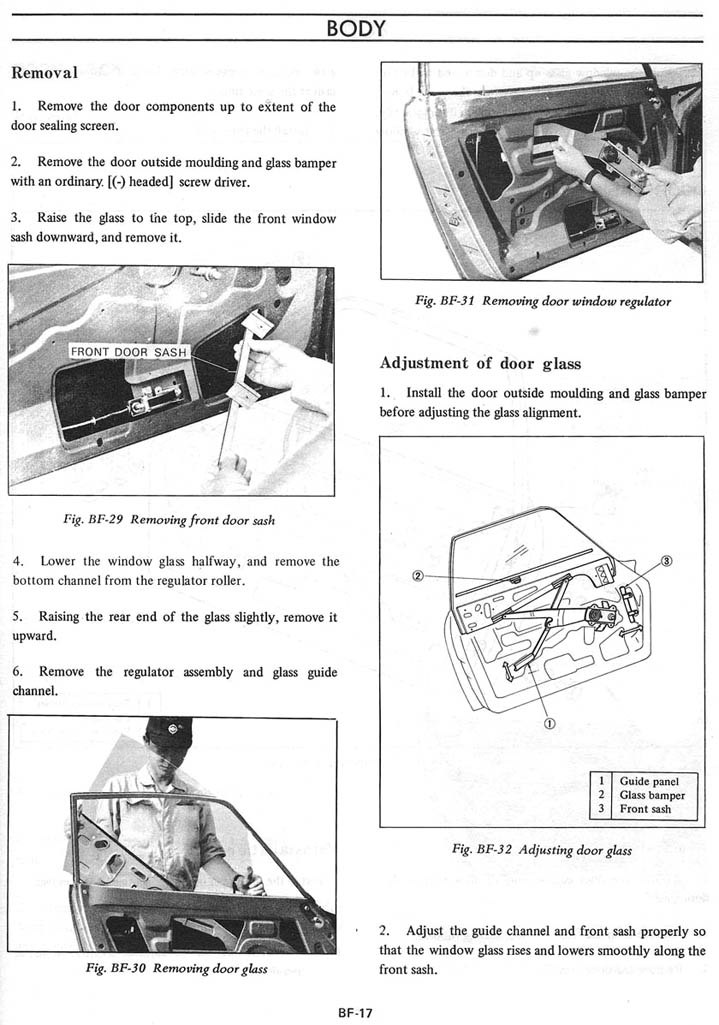

Hi Stephen:
You don't have to remove the stainless steel window frame. You can take the glass out, and put it back in, with the frame in place.
The window frame/regulator etc might be loose as it is mounted to the inner sheetmetal of the door - or the glass migh be loose where it attaches to the metal frame that holds it.
I'd check the mounting points on the inner door sheetmetal first.. and if that doesn't do it.. Then take the window out.
The glass will come out through the opening in the top of the door - but you have to slightly pry the opening apart most of the time. This is always a good place to have an extra set of helping hands.. The widest part of the window has to come out by the area where the door push button/lock is.. at the rear of the door.
Taking the window out - and putting it back in is a snap - Once you have done it five or six times in a month. The first time it can be quite frustrating as you attempt to get all the rollers on the regulator in their proper position relative to the guides they slide in - and they have to be in EXACTLY their proper position to all fit in place a the same instant in time...
I've scanned a page from the Factory Service Bulletin - - re read it as you go along and it will make more sense...
good luck,
Carl B.
