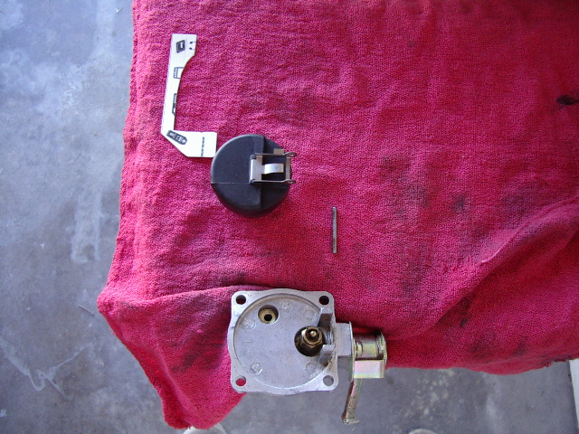

Hey thanks for all the tips guys!
I toyed around with one of my spare SU's that are off the car. I see how the top of the float is setup and the internals of the brass hexagonal deal.
I will pull both the float chamber tops that are on the car off this weekend and clean em up and see what happens!
Will I need to cut up some of my own gaskets? Any tips on the best gasket material?
BTW, I also confirmed I have gas flow to the carbs (downstream from the gas filter), and the fuel appeared clean in a glass
You think I'm safe to run her for a little while by changing the gas filters a few times before I have the tank flushed?

Well I took the float tops off yesterday and very carefully disassembled them and sprayed them clean with carb cleaner, making sure not to bend the hinges that hold the floats on.I reassembled them carefully. When i tried to restart, i again got soaking wet float chambers. And no start as well. I checked to see if the needle valves were sticking but they appear to move freely. Any other ideas on what i should check? The sevice manual mentions fuel pump problems with the condition it calls "overflow". The pump seems to work ok, it pumped gas into a container when I cranked the starter.
As long as you're sure that the needle assembly is debris free, then the only other thing that can be causing the float bowl to overfill would be the float itself being improperly adjusted.
Just follow the instructions in your FSM on adjusting the floats and you should be ok. Tip: Use any bolt that your 14mm wrench will fit and with the float bowl lid upsidedown and level, place the head of the bolt sideways between the float lid and the float itself.
Now as you lower the float on to the bolt head, at the point it just touches the bolt, the float tab should now be just touching the needle. If it doesn't, adjust the tab so that it does.

Great idea regarding the bolt to measure the distance. I will try that for sure!
My mechanic also said try blowing air through the fuel line while raising the float to the needle , just to make sure the needle valve is indeed cutting off the fuel when the tab hits it.
Just curious though, is there any specific reason the floats would suddenly be out of adjustment after the rust incident? Would it involve me simply removing the top of the float chambers, and juggling around with them? I tried to be gentle with 'em.
