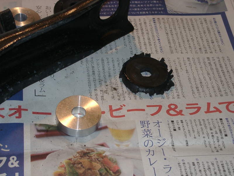

is this the pic? http://www.classiczcars.com/photopost/showphoto.php?photo=17339&cat=500&ppuser=7932
They look like they are turned from aluminimum, any clues on who makes them? or where they are available? anywhere outside of japan? or is it a custom job?

That's the one. Here's a better picture. Must be the lighting because one looks silver and the other is gold. They are urethane, though. They may be custom made to his specifications, but he must have stock on hand. It only took him two days to change out the transmission and replace the clutch and you can't get custom made anything in two days.
