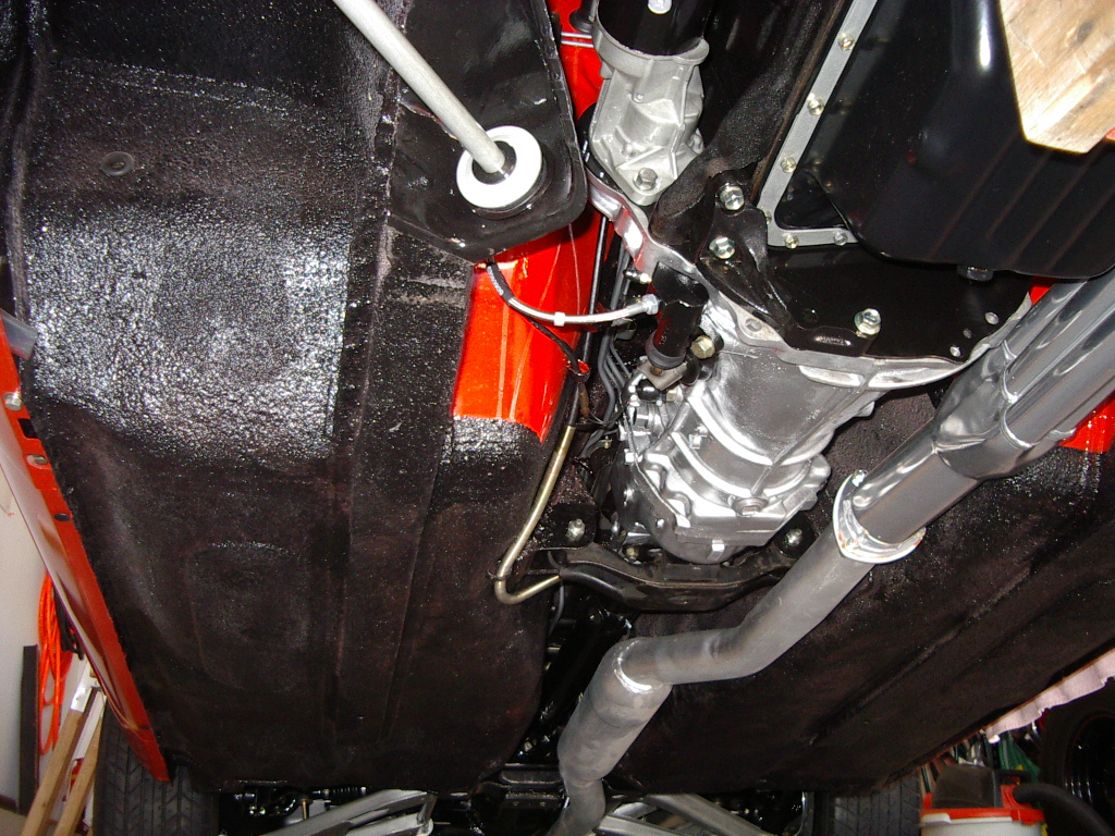

In my search I have seen other people do this and the pre-muffler is tucked up nicely. The pipe then goes to the back with two 90º bends.

Here's a picture for reference on a few bends to have the pre muffler or resinator in my case tucked away nice and tight.

that's a pretty simple elegant solution!!

Ed, that is the main picture, along with your others, that I have used to understand how everything should/could be tucked. When I bought my car it had an MSA kit that hangs too low and is not routed that well.
