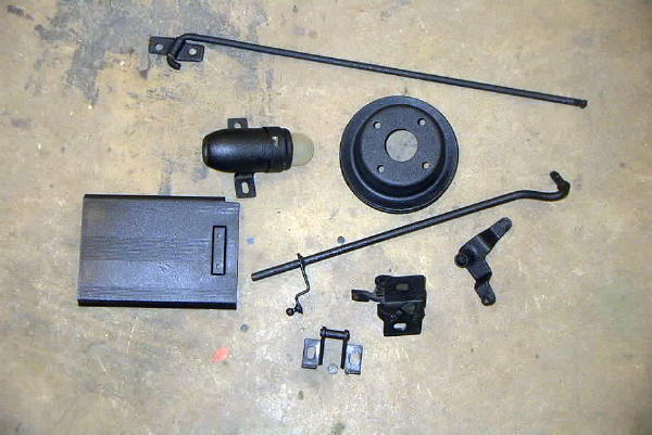

After what seemed like a never ending quest I finally found a free electric range to use for powder coating. I am quite pleased with the results and wanted to say that the HF gun was well worth the sale price. After today's results I'm looking forward to doing other items and have learned allot doing just these few small things.

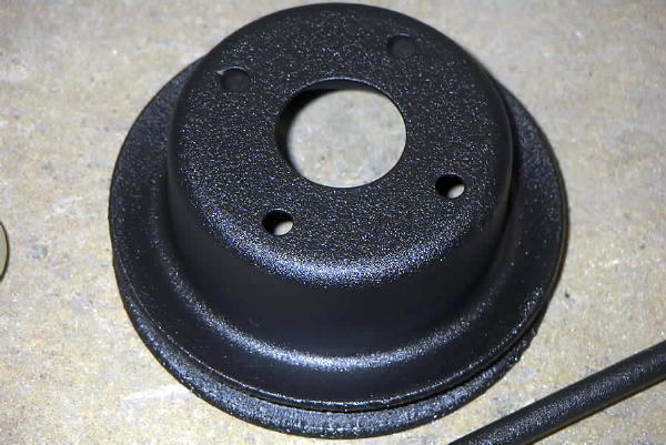

I used Eastwood's powders and they worked well. The items in the pics are all done in black wrinkle coat, the finish looks very old school which is what I was looking for and does cover/hide small imperfections.
I am now planning on building a metal cabinet to coat in so that it will be easier to reclaim the "overspray" powder. The cardboard box I used today worked fine but there is no way to reclaim all of the powder and what is left would contaminate other colors making this a one powder only box.
So I would say that if you were on the fence thinking about doing this yourself go for it, IMHO it works great.
