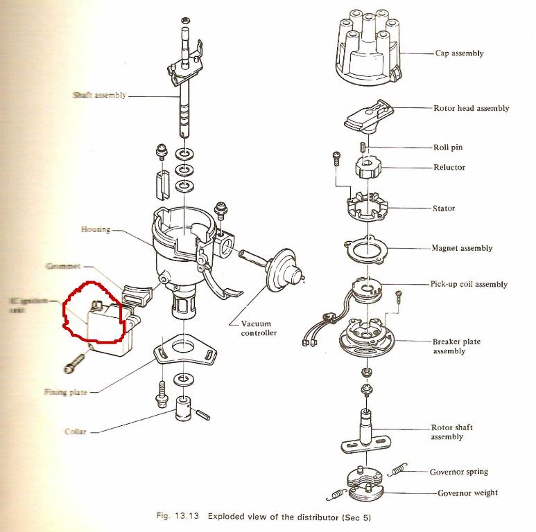

You say the tach is fluctuates. If the tach moves erraticly, seemingly not in sync with the engine's actual speed, try cleaning the connector and terminals at the IC ignition unit on the side of your distributor.
