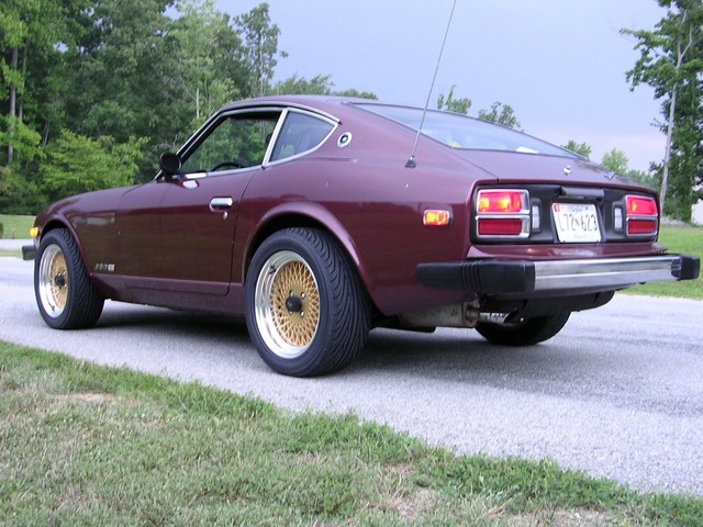

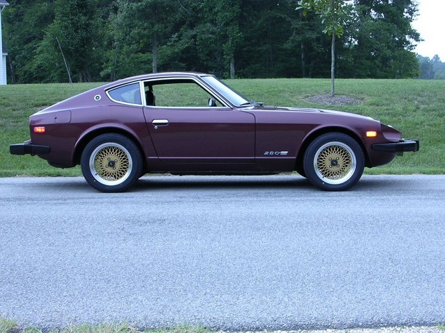

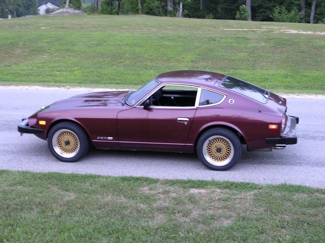

I then set about to research the wheelspacer subject and after stumbling across a great thread over at grassroots motorsports I decided to have a set built. In my case I used a fellow who advertises via ebay and will produce a custom set for $140 out of T6061 aluminum. In about a weeks time I had the new wheel spacers which bolt onto the existing hub and with the Nissan 12x1.25 thread the new studs protrude from the spacer to accept the wheel. The minimum thickness has to be one inch and with the wheels measuring 7 inches wide from the inner bead and eight inches from the outer bead I figured it would be close for clearance purposes.
The front valence panels where they meet the wheel house had to have the lips 'rolled' so that when reversing and turning at the same time there would be no rubbing of the tires. Beyond that the car runs and drives just fine and in the near future the motorsport non ducted front air dam will be installed and paint matched.

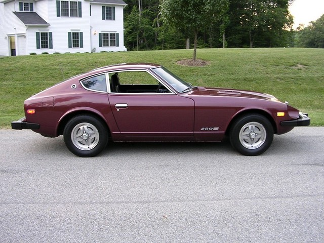

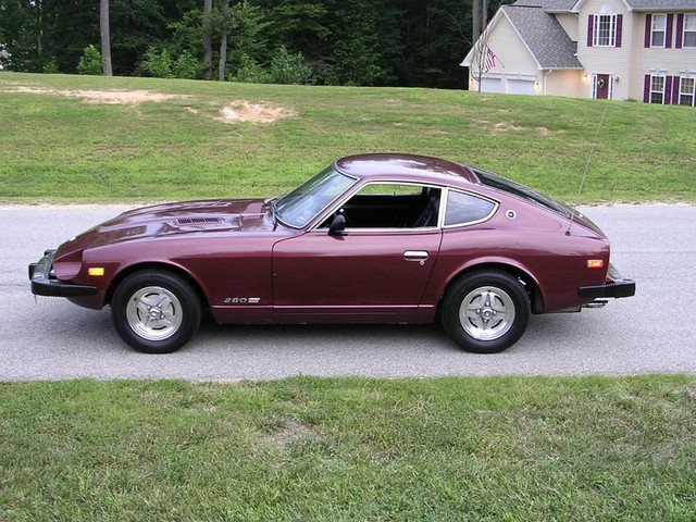

Enclosed are a few before and after pics:
