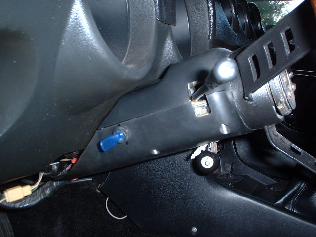

So I thought one of my headlights on my '75 280Z had the high beam out but it turned out to be the turn signal/hi-low switch. After removing the steering column jacket and then the switch assembly it's apparent that the hi-low switch is toast. MSA wants $225 for one of these assemblies and I'm thinking that's a bit much. What the switch does is very simple but the OEM design is really wimpy. I run by the auto-parts store and pick-up a two-position three-pole 20 amp switch. This particular unit lights up blue when in one position. Perfect for high-low beam! I clip the wired connector off the fried switch and crimp on terminals. Now to mount the new switch in a convienent position on the jacket. I picked a position about 3 1/2" from the turn indicator lever. While I'm drilling the hole for the switch I notice how fragile the jacket is. I've often marveled at the Datsun engineering of this car but this part is really thin. With the switch mounted and tested I begin to put the jacket top and bottom togeather and I've got to be very carefull. This thing is like an egg shell! Well, I got it screwed together and the switch works nicely but I'm not looking forward to ever opening that back up again!

Agreed. I usually try to keep the car as stock as possible but this was one instance where I just couldn't justify that much cost. That $225 will buy all new emblems (except hood)!
