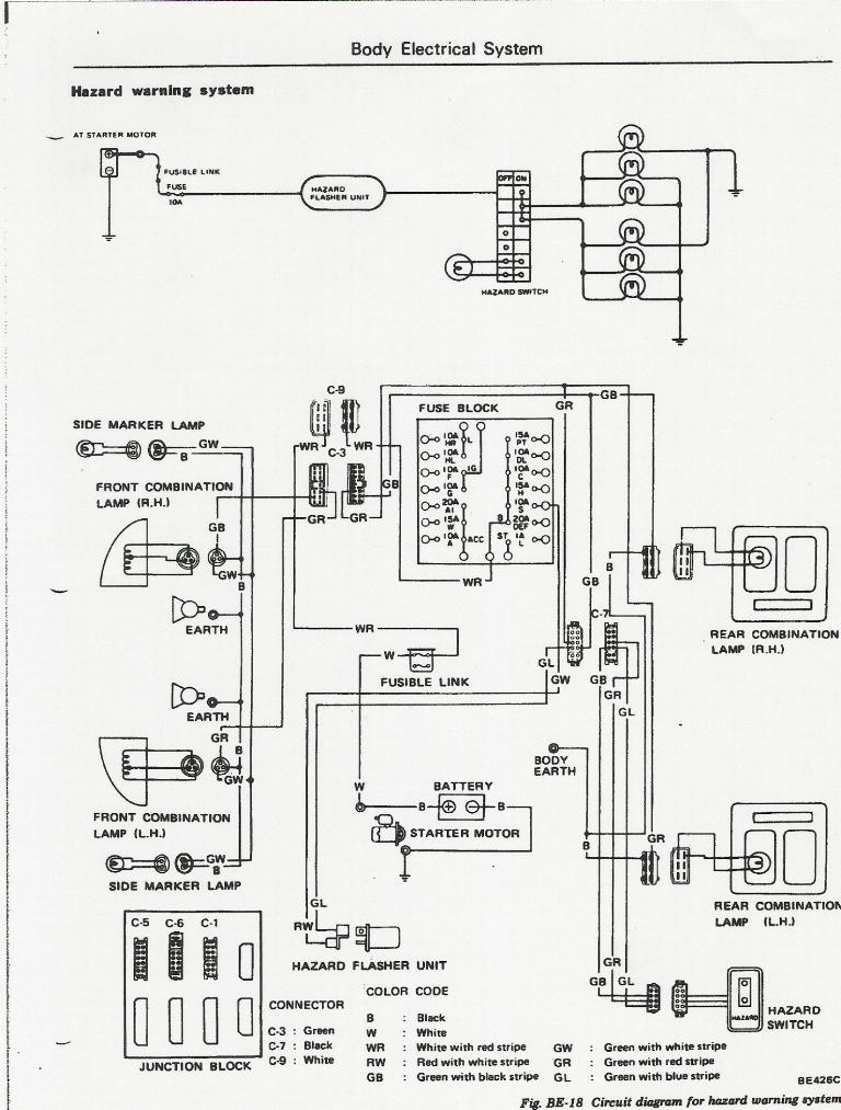

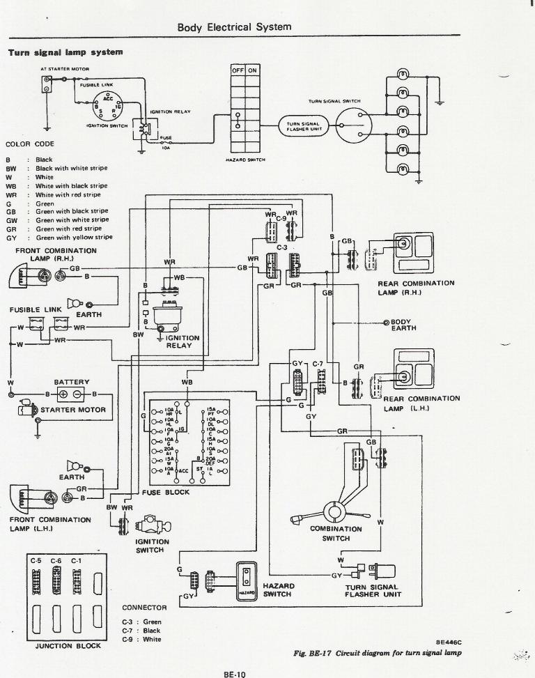

It's probably not a fuse but if you have one that looks burned, change it. There is a connector located at the right just under the front of the console that ties these two systems together. (turn sigs/hazzards) I used to have intermittent problems with mine not working and I solved it by cleaning the contacts on this plug. It is labled C-7 in both of the scans.
Yes, but they are strictly wiring diagrrams. That is, they show the lines going to components and they interweave like an neurotically obsessive compulsive spaghetti plate, but aside from the colors of the wires (and there ARE a couple of errors) and their beginning and starting point, there is very little in common with what you're showing.
The diagrams you posted not only have the wiring schematic drawn out for a SINGLE component of the car, they show you the CONNECTORS and the INDIVIDUAL wire connector in relation to it's POSITION in the multiple wire connector.
