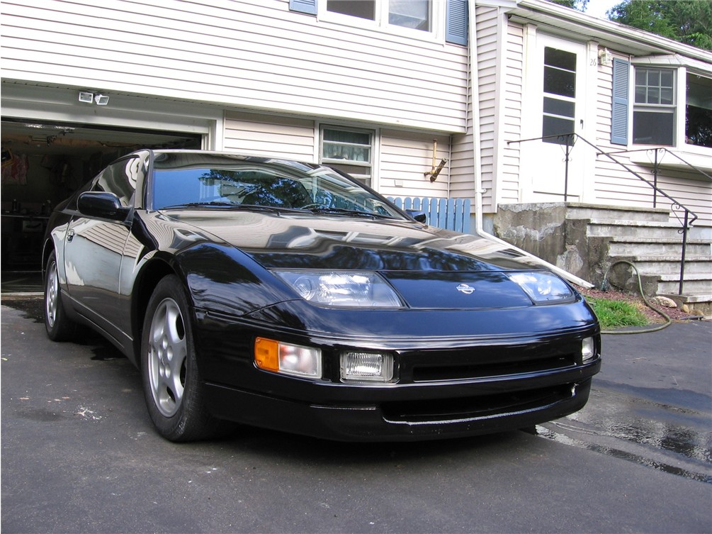

I'm far from an expert but I just finished the front of the Z32 with some coaching of a body shop owner/ neighbor. You don't need to sand to metal if the paint has good adhesion.If you decide to strip it clean you can use aircraft stripper. Do the best prep work you can or it will show up. If you can feel any imperfections with your hand you will see it. Make sure you degrease/clean before sanding/scuffing or new paint will lift. If you prime it is best to use the same paint system as the painter I am told. I'm sure others will have more to add. Good luck
