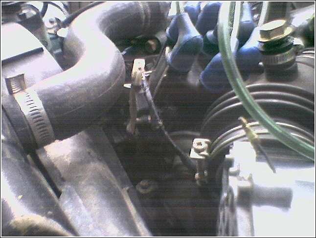

Ok, a bit late, but I have pics of this thing. Not that it looks much different from any of the other intergrated IC distributors :). Oh, and it has the two extra lower prongs (can't seem them here) that I've seen on the e12-92 IC unit.

It's hard to tell from the pics if it is the distributor I'm trying to identify.
What will probably be best if If I take a picture of my distributor upclose and personal and get others to comment.
I do know this the distributor I have and am trying to find similar ones of contain mitsubishi parts in them and are marked on the module and rotor button.
I know because I thought it was strange at first but I'm trying to locate these as I feel they are quite well built over the E12 ones. :eek:
I think this one has the 'mitsi' stamp on the body somewhere, if memory serves. The rotor definitely does, right on top. I do have misgivings about the IC unit, however. They stem from comments on Zgarage regarding the performance of the e12-92's, which are meant for EFI control (the extra prongs). If there's a particular marking you're looking for I can check tomorrow.

If you could provide a picture of the module on the distributor that would help it seems like it's the same size as the E12 module which would indicate it's not the correct one I'm looking for.
I really should provide a picture of mine and compare it with the E12 style distributor so people can see the difference. I'll make sure I do as soon as possible.
