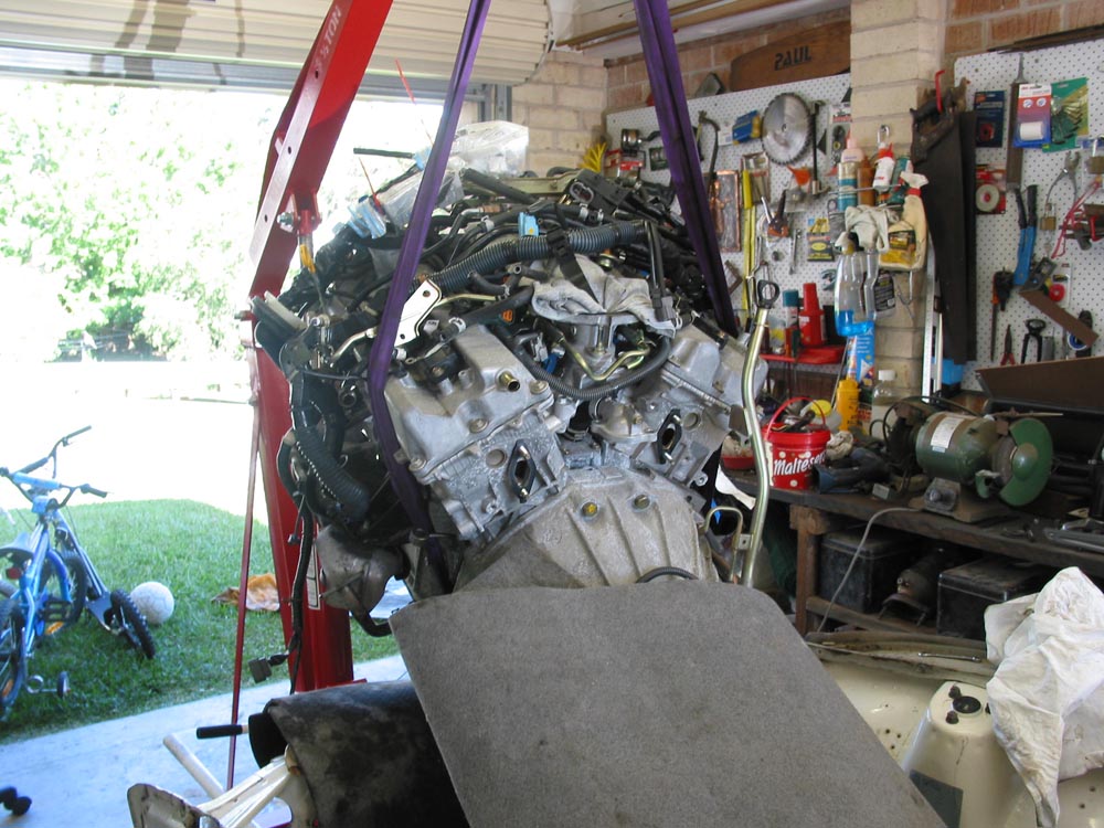

This is my current project - putting a VQ30 DET into a 1974 260z.
zcar project
This engine is from a 1999 Nissan Cedric.
To put this engine in I have had to remove the exhaust which runs behind the engine and the turbo to fit the engine behind the x-member. Then I will have to have new exhaust manifolds made bringing the turbo in front of the motor.
The plenum had to be removed because it was too far off the back of the engine, so a new one will have to be made towards the front of the engine. I will have to make a new x-member and modify the engine and transmission mounts.

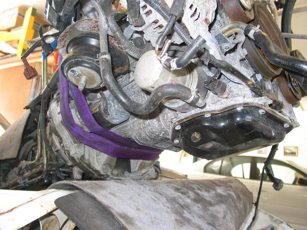

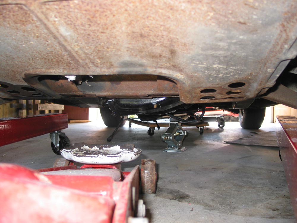

I have a couple more questions for you. What's the sump position, I can't quite see it in any of the photos? Also, roughly how much taller is the engine with the inlet manifold on? How far back does it sit from the engine?

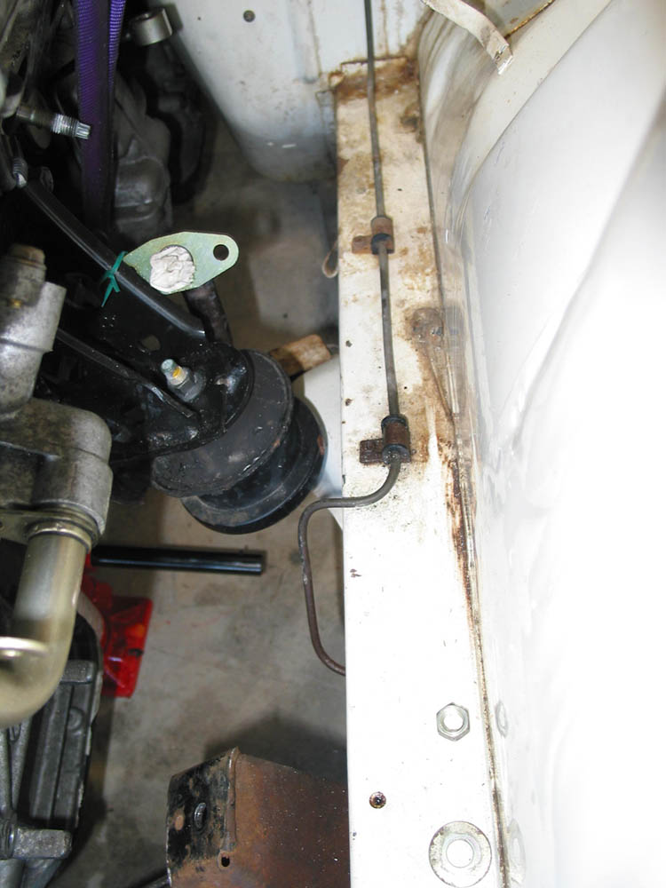

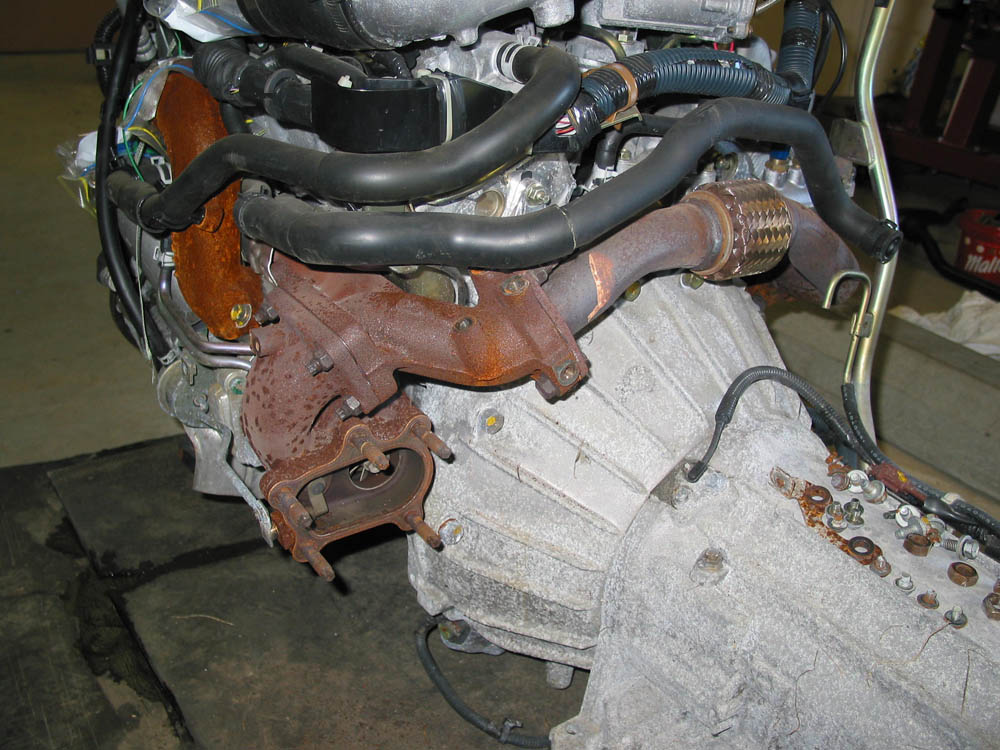

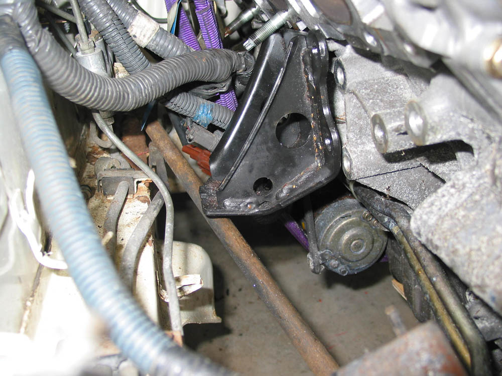

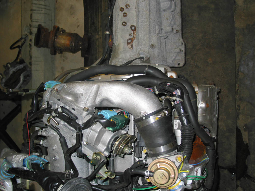

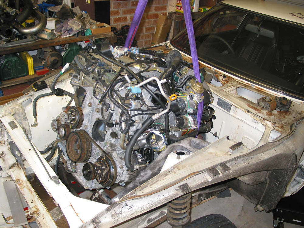

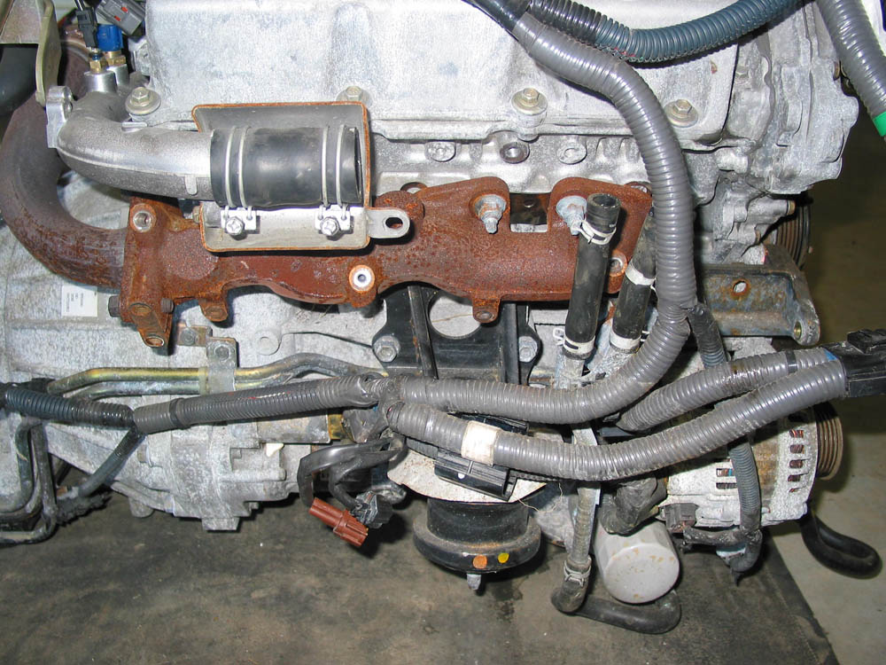

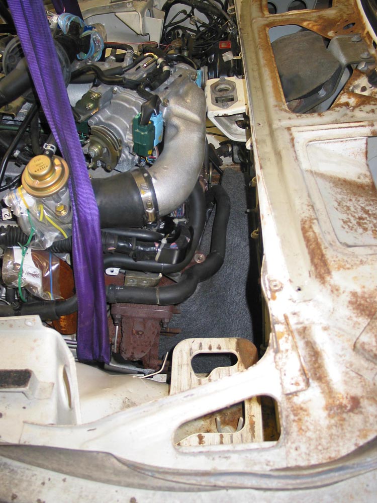

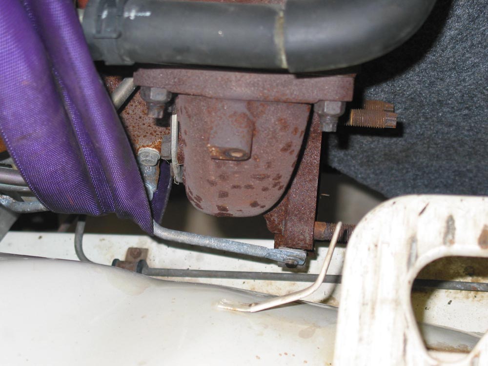

Here are some pics of the exhaust after the heat shields were taken off and also the first trial fit, it didn't fit.Showing the turbo would foul the rail on left side and how far back the intake manifold is. By removing these I was able to move the engine back about 5-6".

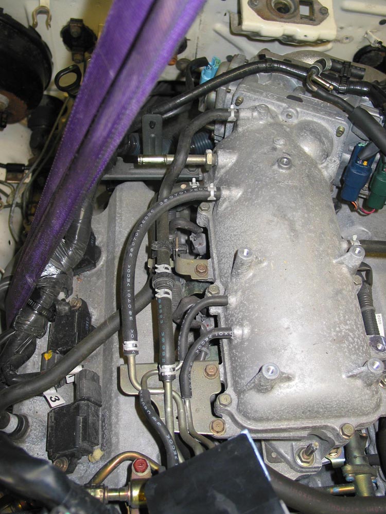

More pics showing the inlet and plenum, then the back of engine with all the bits removed even the water pipe which was later reinstalled because I found that It could be retained- saving me a lot of work.

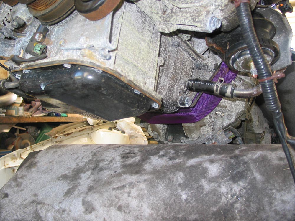

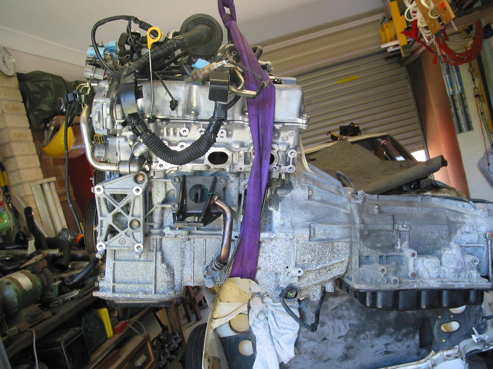

Next one showing how far the sump sits below the x-member.
