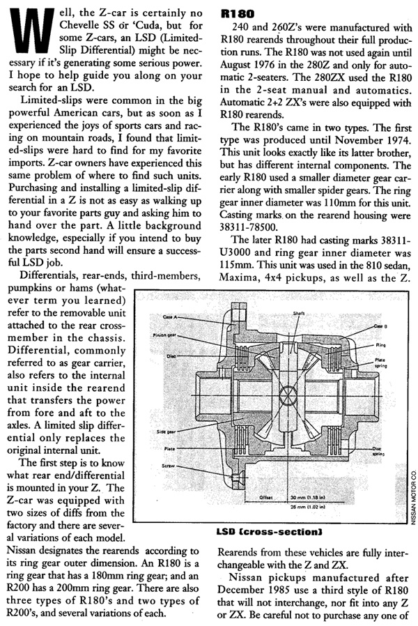

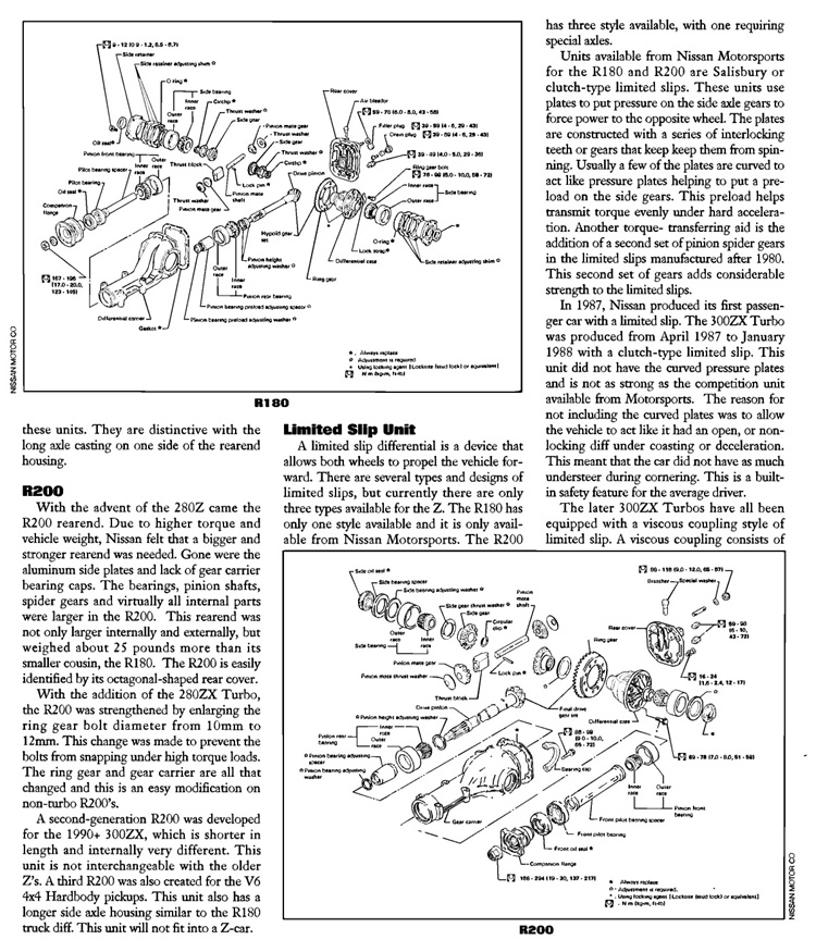

Hey Mike,
I was cleaning out my old files and came across this usefull tech piece.
I don't know if its legal to add to the technical article area though. The author's name and ph. # appear at the end of the article. The "add or delete" decision is yours.
Phred
PS Sorry about the big files. I don't know the best way to send them, and have them legible.
That's a good article but not entirely accurate. The Power Brute is a Nissan clutch type LSD, the 12mm ring gear bolts seem to have been introduced around 85/86, the 300ZX does have spring plates but not spring discs which still gives it some preload, etc.
By far the most detailed and accurate info I've found is here: http://www.gordon-glasgow.org/lsd1.asp
