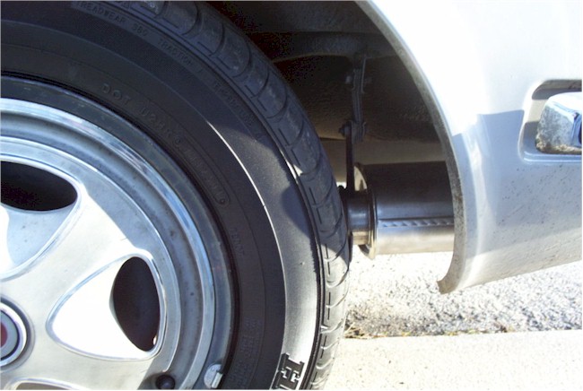

April 26, 200223 yr Author comment_6251 Well here's some pics, just in case anybody wants to try and internet-diagnose... i can take more of specific areas Link to comment https://www.classiczcars.com/forums/topic/1479-msa-exhaust-fit/#findComment-6251 Share on other sites More sharing options...

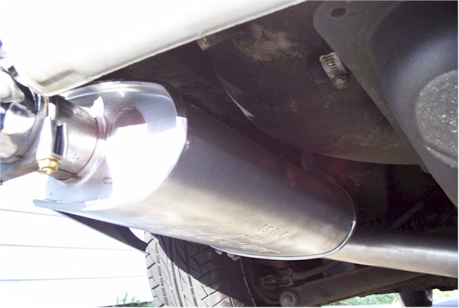

April 26, 200223 yr Author comment_6252 exhaust pic 2 Link to comment https://www.classiczcars.com/forums/topic/1479-msa-exhaust-fit/#findComment-6252 Share on other sites More sharing options...

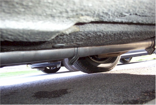

April 26, 200223 yr Author comment_6253 exhaust pic 3 Link to comment https://www.classiczcars.com/forums/topic/1479-msa-exhaust-fit/#findComment-6253 Share on other sites More sharing options...

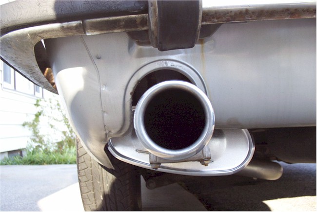

April 26, 200223 yr Author comment_6254 exhaust pic 4 Link to comment https://www.classiczcars.com/forums/topic/1479-msa-exhaust-fit/#findComment-6254 Share on other sites More sharing options...

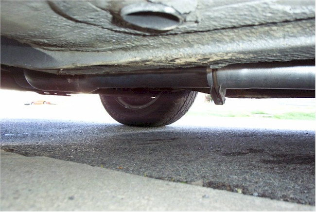

April 26, 200223 yr Author comment_6255 exhaust pic 5 Link to comment https://www.classiczcars.com/forums/topic/1479-msa-exhaust-fit/#findComment-6255 Share on other sites More sharing options...
April 26, 200223 yr comment_6256 I think it may due to the muffler. The muffler that comes in the kit I have is an offset inlet/offset outlet. The muffler is mounted vertically, with the inlet on top and the outlet on the bottom. Yours looks like a offset inlet/ center outlet, but if you try to turn it so the mufflers flat sides are more vertical it might work.Try loosening the clamps on the mufflet and underneath and turning the muffler. You might get it to line up better if you turn it more vertical thereby raising the inlet slightly and it will pull the rest of the pipe away from the centerline of the car and this may straighten the outlet in the opening. That is if they didn't crimp the pipes so much with the old style clamps so that the pipe won't turn. One reason I love the band clamps, you can loosen them and re-adjust the pipes, and you won't have the crimp in the pipe to make is so hard to pull a pipe off. Link to comment https://www.classiczcars.com/forums/topic/1479-msa-exhaust-fit/#findComment-6256 Share on other sites More sharing options...
April 26, 200223 yr Author comment_6265 I think they tried it vertically, but I'll try it tomorrow. It looks like they didn't weld the hangers on, just slipped then underneath the clamps. I think I'll also call MSA to see if I got the wrong type of muffler! :-) Thanks again, 2ManyZs. (and again, and again, and again ) Link to comment https://www.classiczcars.com/forums/topic/1479-msa-exhaust-fit/#findComment-6265 Share on other sites More sharing options...
April 29, 200223 yr Author comment_6367 They crimped the pipes with the old-style clamps. I couldn't get it to budge at all The shop that did it claimed that the pipe before the muffler "must be bent wrong" because it wouldn't line up to the muffler if it were to be in the "right way". Guess I'm stuck for now... Link to comment https://www.classiczcars.com/forums/topic/1479-msa-exhaust-fit/#findComment-6367 Share on other sites More sharing options...
