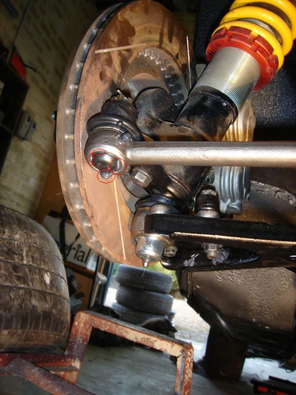

So anyways, when fitting my new outer tie rods ends, I noticed they had the grease overflow nipple provision mentioned. I packed them with grease and it seems to overflow from the bottom before the boot fills.
This wouldnt appear correct to me? :stupid:
Not sure I understand where the grease is overflowing from. Do you mean that grease comes out from around the bottom of the boot (where the circular spring secures the boot to the housing?
Maybe squeeze the "overflow nipple" on the boot to make sure it opens to allow grease to come out. That's the only thing I can think of.
Sorry, I should have explained the photo.
If you look at the very bottom of the tie rod joint you can see the grease squeezing out between the black part and the metallic part.
