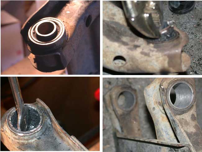

I learned a trick to removing the spindle bushings on the outer control arm while making my swap from stock to urethane. The bushings are actually pretty easy to remove once you figure it out. I've attached some pictures to help describe what I did. I started by drilling the rubber to loosen it a little (I'm not sure if this really helped or not but it's what I did) next to the inner sleeve. Next, I attached some vicegrips to the sleeve sticking up. I then heated the sleeve from the underside and interior with a propane torch for a few minutes. Once the rubber started to soften, I used the vicegrip as a fulcrum to pull the sleeve up and out of the rubber. The vicegrip popped off a few times but as I kept heat on it the sleeve slid right out. Then I used a drill with a 1" paddle bit and drilled out the rubber. After that, I placed a hacksaw blade through the remaining bushing and cut two grooves about a quarter rotation apart through the sleeve making sure not to cut into the control arm. Then I took a flat blade screwdriver and started working on one of the grooves until the sleeve let go. The heating and drill took about 5 -10 mins and the hacksaw part took about 10-15 mins. each. Unfortunately, I didn't refine this process until my last bushing. :( I think it would have gone pretty quick for me had I known a good way to get these bushings out. There is a similar technique in How to restore your datsun z-car but you must hack through the rubber and two layers of metal. I think removing the inner sleeve and drilling was easier. After cleaning up the opening I greased everything, I mean everything and attempted to reinstall the CA.
That's when I found out another trick. The urethane bushings I used, by suspension techniques, have collars on them that reduce the opening of the CA by an 1/8" or more. I couldn't get that thing back on. After an hour plus of fighting, I got pissed off and cut off the collars on the inside part of the CA with a knife and the CA slipped right back into place. You'll notice in the photo's the original bushings don't have a collar just a sleeve. Unfortunately, I don't have a picture of the bushings so if you haven't seen them the collar part might not make sense. I'm not sure if what I did was right, but the way it sat without my cutting the collars off meant I wasn't driving. Everything seems to be working fine and the new bushings are basically the same now as the original bushings. Hopefully, someone might be able to use this stuff and speed up there bushing replacement. Also, I'm no mechanic so if anyone wants to chime in with other observations, great.
