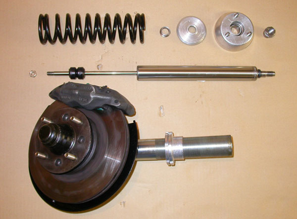

Anyway, first of all I think you should make 100% sure whether your brakes are the VENTED or NON-VENTILATED type. I'm worried that you are not clear about the difference; it can be hard to see if the wheels are in place.
Please take a look at these two photos. They show a VENTILATED type MK63 caliper and disc combination. Please notice that the disc is not 'drilled' - but that it is cast with the ventilation slots in between the two friction surfaces ( 99% of front brake discs on standard road cars are like this nowadays ):
Once you have made sure whether you have the ventilated or non-ventilated versions, you can make some other decisions;
If you have the solid, non-ventilated discs then they are the STANDARD discs that came on your car when it was new. This means that you could change back to the standard 2-pot S12 calipers if you wanted to go for a cheap, easy and Factory-stock application. I have some used calipers which I would be happy to give to you should you have trouble locating these in Portugal. You could just bolt on the calipers and still use the existing discs ( if they are in good condition ).
Remember that this will make things far easier for you in the future - as the standard parts are easy to get, easy to look after, and when they are working properly ( with good friction pads ) they are quite adequate for a road car.
If you confirm that you have the VENTILATED version, then things could become more complicated. The discs themselves are no longer available from NISMO or Nissan. Aftermarket versions are available in Japan - but again they are expensive. One alternative is to use a Peugeot disc and re-drill the four hub mounting holes ( I can give you the details for this ).
Buying new MK63 calipers and ventilated discs will be very costly. You might therefore want to consider reverting to the standard brakes.
In any case, the seal / repair kit is the same for vented and non-vented calipers. Maybe you should make the final decisions after stripping your existing calipers and checking the condition of the pistons and piston bores?

my disk is not that . its the solid disk

OK - we have established that you have the SOLID disc version of the MK63 4-pot caliper.
Please make sure that you quote the part numbers of the SOLID disc version when you are buying parts. Some parts differed between the two versions ( especially the pads ) so please be careful.
