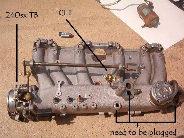

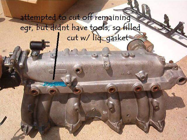

I stumbled across a guy selling a megasquirt, 280ZXT intake/injectors, 240sx TB, ZXT fuel pump, etc, $250 shipped. Seems like a good deal, until he sent me this picture of the intake. What's the deal with this thing? Is the affected area the EGR passage as he suggests, and is it connected to the plenum anywhere?
I guess I'm just looking for someone to explain what's cut on this thing and if it's usable.

just looking at it, I don't trust it...
he must have cut down the EGR soo far, he actually went through and there is a hole.
Unless you can weld it back and seal it up... i wouldn't trust it.

Hahahah Carl, you slay me :P No sweat, I wandered over the zcars.com and got the answers I needed. Strangely enough, the ZXT intake really does have the EGR running under the plenum like that. Wierd stuff. Anyway, he's going to get it all welded up, then I'll try to sneak out to the garage to megasquirt the thing. I am SO impressed with it on my other car, it's nutso.
