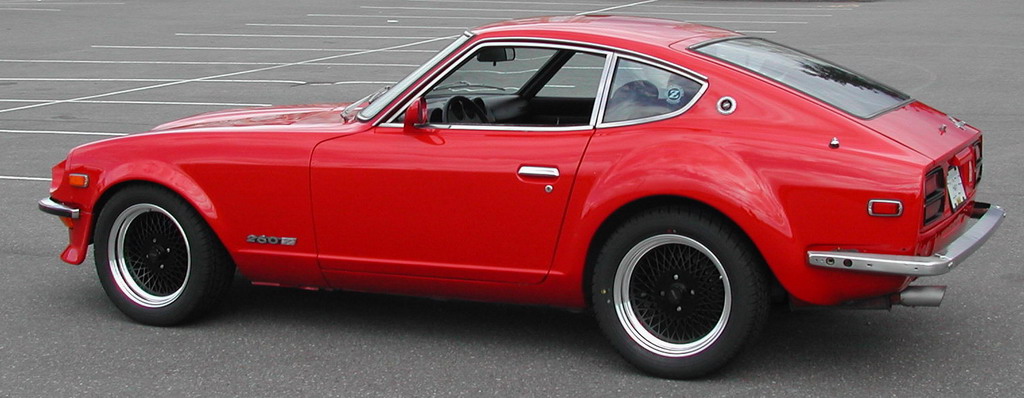

May 6, 200421 yr comment_79954 I'm running 16 X 7 Enkei rims with 225 50 series tires. Stock suspension, no spacers ... I have wheel flares, but underneath are the original wheel wells (untouched). Richard Link to comment https://www.classiczcars.com/forums/topic/11507-widest-wheels-and-tires/?&page=2#findComment-79954 Share on other sites More sharing options...
May 6, 200421 yr comment_79966 Richard, Those wheels look great! Now if only they would go back into production with that style of rim again! Link to comment https://www.classiczcars.com/forums/topic/11507-widest-wheels-and-tires/?&page=2#findComment-79966 Share on other sites More sharing options...
