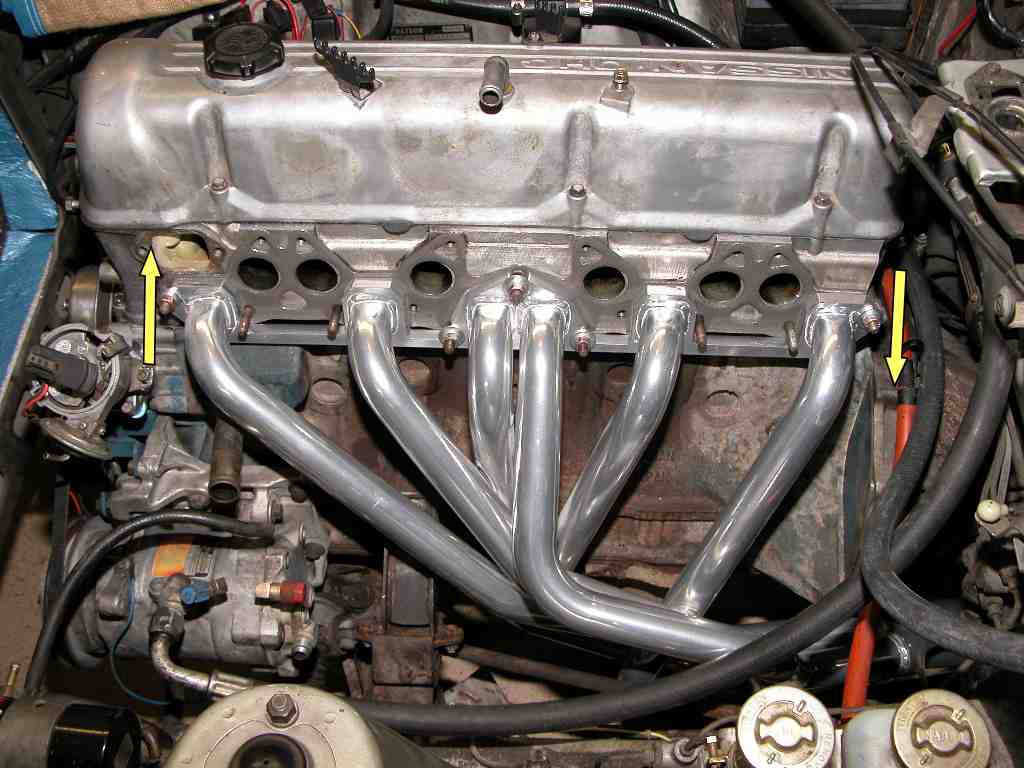

I'm putting my new MSA 6 into 1 header and exhaust on and am running into clearance problems. I'm surprised because I had heard that MSA's was just a bolt-on. The issue is the outlet is just a little too high. The results in the pipe that connects to the outlet hitting against the transmission rear cross member. If it was about 1/2" lower, I think all would be fine.
So I've tried "rotating" the header on the head as I tried to illustrate in the picture. But in order to go any further I'd have to remove some material from the flange as it's hitting against several of the studs right now. Of course, I hate to start grinding on something brand new, especially since I've got the ceramic coating.
So my question is if any of you have used the MSA headers before how did you resolve the clearance issues.
And if grinding is the answer, give me some advice. I've never done that before (save using a file by hand).
I had the same headers on my L28 with a 5speed. I don't remember any clearance issues. They bolted on real nice.
I too had no issues with mine. Perhaps there was a defect in yours or its an altercation? Call MSA and perhaps exchange it?
Ok, must be something with mine. I'll have to call MSA.
dido with my header:ermm: Although I do have a 6 into 2 but still. I'd call Motorsport you shouldnt have to grind on your NEW $300 header.
Good luck

I had the same problem when I installed a MSA 6-1 jet hoted header into SilverBullet240Z. The two bottom bolts (5&7 oclock) fit and could be snugged up, however, the top bolt (12 oclock) could only tightened to a point where there was a 1/2 inch space between the flanges. A noisey drive to the shop to have the connecting pipe flange fitted. Worked fine and no further problems.
Header is mounted normally on head with no twisting.
Ken
Ken, I think you're describing exactly my situation. So it sounds like you had them weld the 1st piece of muffler pipe to the flange for connecting to the header so that it could go down at more of an angle? This would be angling down from the engine towards the rear of the car? Did that cause any problems with the other end of the pipe hanging down too low?

The first muffler pipe with flange connection was cut on a slant (/)
and the muffler pipe was cut to match, so that the rest of the system was aleigned properly, then welded together. Nice neat job and it looks custom. Car still in winter storage so I can't snap a photo.

Thanks Ken, that makes sense. And that would solve my issue as well. Just kind of frustrating to have paid them over $400 for a header and muffler system that's supposed to be bolt-on, and then need to go spend even more money to get it kluged.

Thought I'd give an update on how this all worked out. Turns out the supplier of the headers to MSA had a problem with the jig they use to bend and weld the pipes. They built up a second header, coated it, and got it to me. Also made some changes to the first pipe behind the header as well as the angle of the flange. It went together pretty well, and last weekend I had a local muffler guy make a few more bends as it was hanging down more than I liked.
I also added an 18" glass pack as it was just a bit too loud for my neighborhood. Sounded great to me, but I knew my neighbors wouldn't have the necessary sense of humor:finger:
It's a great combination now: quiet at light throttle, and still has a good deep sound when opened up.
