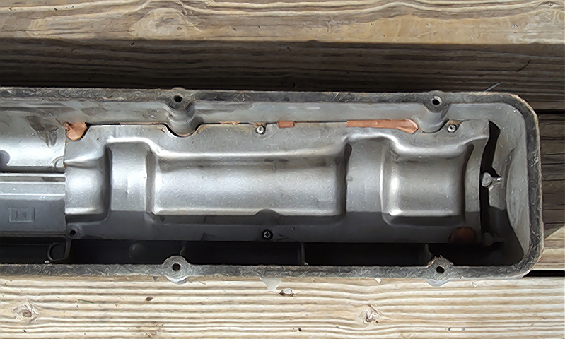

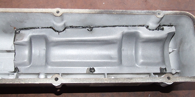

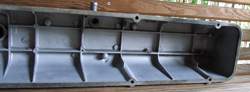

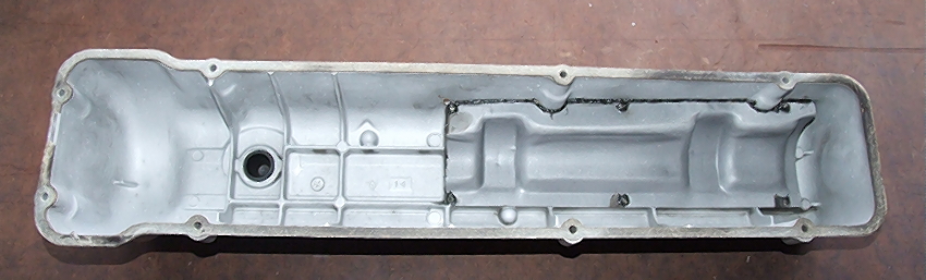

This is an old thread, I know, but it came in very handy for a repair that I had to do.... One of my cam covers suffered from deteriorating sealant as described, and I tried the fix that was suggested with Permatex #2. So far the results are excellent, but I will have to report back later on how it holds up under use.
Attached are some before, during and after pictures if you are interested.
Before the clean-up and fix. Note the missing screw (which may have contributed to the fact that I found the donor car in a boneyard).
During the clean-up (media blasted)
Then reassembled and sealed up with the Permatex #2 (messy, messy stuff during my experimentation of how to run a bead, but I figured it out!)
