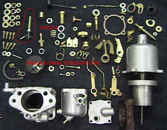

sorry to bring old thread back, didn't want to make a post for this. I will be ordering the rebuilt kit for Ztherapy, but what are the nozzles that I need for refund?, my mechanic does not speak english, how do they look like or anyone as a pic? thx guys
Go to the auto parts store and get a gallon can of carb cleaner. Drop the carb pieces (no plastic) into the can a give it a soak for several hours. If crud is holding the nozzle in the solvent will soften it enough to easily remove. I've done this the get cemented adjustment screws out of Dellorto's with ease.
