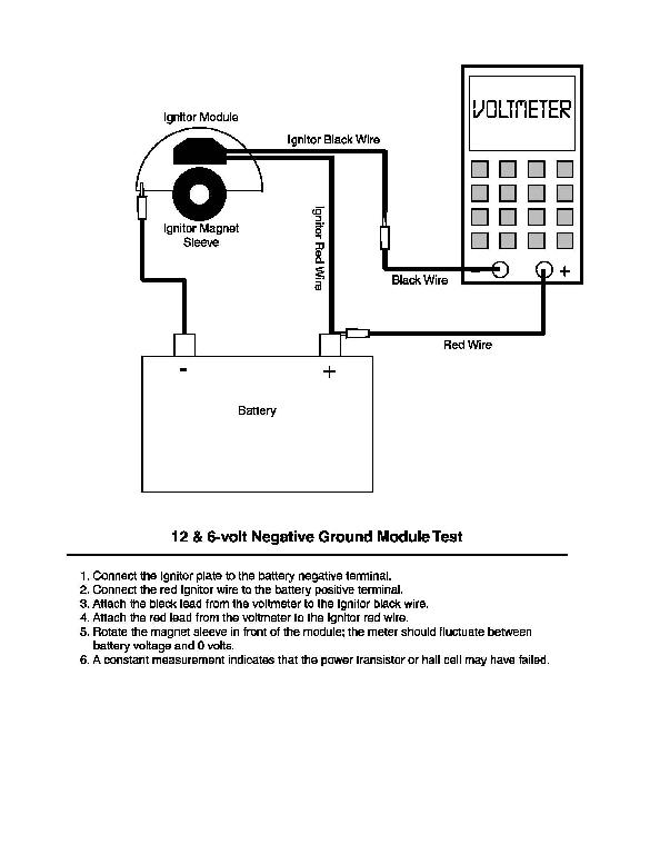

Year is 72, Looks like original Wiring according to colors. The first one fried and I replaced the points and everything was OK. The second fried and now the points won't work either. I have tested both units with the battery and ohm meter scheme of rotating the magnet in the unit but the both stayed closed whitch I was told means they are bad.

no smoke, but the unit is always passing 12 volt through instead of on off ect. Pertronix informed me of a way to test the unit (pictured). Yes, I disconnected everything from the negative side of coil and the condenser and points. The only wire going to negative coil is the black wire from pertronix./?????
It sounds like you had the unit installed correctly. Were you able to measure battery voltage at the end of the ballast resistor that you connected the RED wire to? Have you tried to start the car with the unit installed? I never tried the static test that you have been doing, but I've been told that he pertronix should fire without regard to RPM so it would make sense for the fluctuation you mention to occur when rotating the magnets by hand.
I'm just not sure about the diagram showing the black wire connected ONLY to the volt/ohm meter (in other words it NOT being connected to the NEG of the battery. I dunno. I'm no electrical whiz, I just followed the directions and it works great for me.
