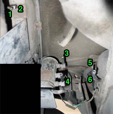

Like an idiot I took something a apart and can't remember in the old age of my 30's how to put it back together again. I started the minor repair a month and half ago and am just getting around to completing it.
Its the back rubber hoses that that go from the tank to the electric pump and then to the rail. The attached jpg explains it pretty well. I guess I should replace the fuel filter while I am at it.
Just tell me what numbers go to what. Like 1 to 3 for example.
Thanks for the help.
-Dave
Going from memory the input of the pump should be the bottom and the output should be the top.
So, it should be 6 to 4 and 3 to 2, with the return line 1 to 5.:ermm:
