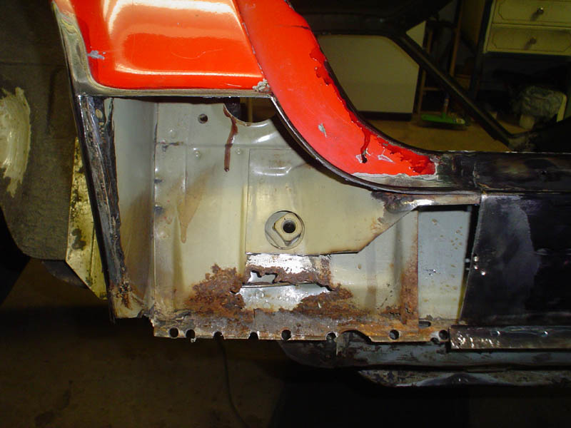

Posted October 22, 200321 yr comment_54147 Here are some rust repairs that ive been working on. note the black stuff is rust killer. Link to comment https://www.classiczcars.com/forums/topic/8510-rust-repairs/ Share on other sites More sharing options...

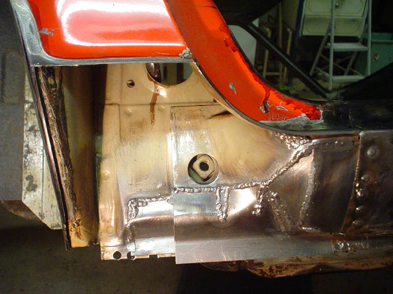

October 22, 200321 yr Author comment_54149 After cutting rust off and welding new steel. Link to comment https://www.classiczcars.com/forums/topic/8510-rust-repairs/#findComment-54149 Share on other sites More sharing options...
October 22, 200321 yr comment_54157 hey man nice welds! def looks like you are using gas Link to comment https://www.classiczcars.com/forums/topic/8510-rust-repairs/#findComment-54157 Share on other sites More sharing options...
October 23, 200321 yr Author comment_54248 Yep your right its gas. I have the option of getting someone to TIG weld, my concern is that TIG might be much hotter than MIG and I wouldn't want the surrouding steel to warp especially if its anywhere visible. Would anyone here recommend TIG? Link to comment https://www.classiczcars.com/forums/topic/8510-rust-repairs/#findComment-54248 Share on other sites More sharing options...

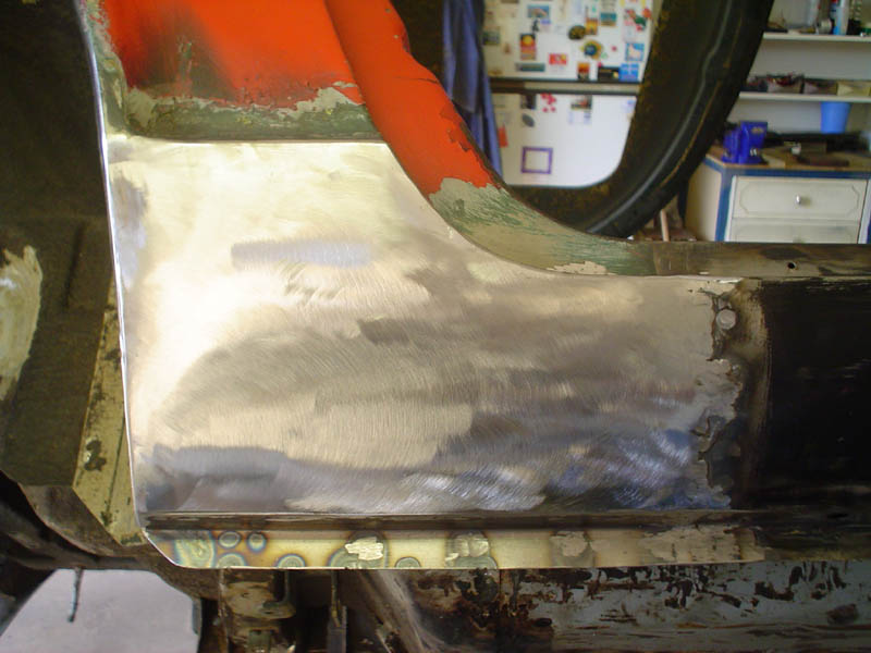

October 25, 200321 yr Author comment_54566 mperdue, Thanks for the compliments, here is a shot of the finished dogleg, a finned sanding disc was used to smooth the welds. Link to comment https://www.classiczcars.com/forums/topic/8510-rust-repairs/#findComment-54566 Share on other sites More sharing options...
